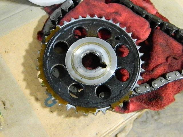

Does it have an all steel camshaft timing gear? I had an old Chevy nylon gear disintegrate on me, with the same symptoms you're have. Also, when I tore down the 383 I bought, there was a small handful of nylon cam gear teeth lodged in the oil pickup. It can happen! Good luck, and please update when you figure it out.

The sudden onset of the backfiring and rough running sound exactly like the problem I had with my old 68 Buick 350, namely a skipped timing chain. Removed the timing cover and found the chain had skipped a tooth on the cam gear. Removed and replaced both cam gear and chain and all was good.

The last time I had a problem like this the cam chain had jumped a couple of notches...had spark and gas to every cyl. but no run....make sure you don't have one of those hinky plastic tooth cam sprockets...
