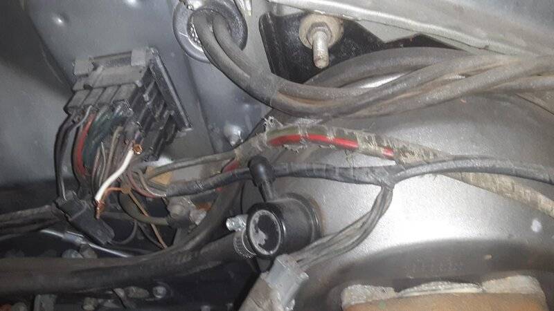

just because pull your fuses and check for corrosionIt was running great then started backfiring and losing power. Limped it home and can't get it to fire once. On advice from here, changed the points and condenser. Changed the coil. Changed the plugs. Changed the ballast resistor. Set the timing at 13 degrees.
It cranks well. I'm pouring gas or starting fluid down the carb. The plugs get wet after cranking. I've got spark, at least at the plug wires. It won't fire once.
The wiring at the bulkhead is kind of hinky. There's a jump wire going from a brown wire that isn't connected to the box to a sprig of a wire shoved in next to a purple wire at the box. I took off the jump wire and I got nothing. No crank, lights, anything so I put it back.
One weird thing. When we were limping it home and it was running terrible, it ran well for two blocks then ran terrible again.
