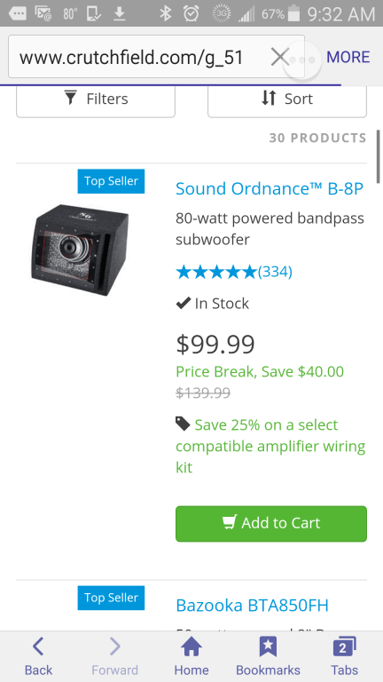

This has me thinking?? The price worries me but supposedly it's a German made product and has some really good reviews. It's Crutchfields brand, I'm running one of their amps and really like it. The 8" woofer should be very responsive to the drums and at that price you can't go wrong. Not looking for a booming system just wanting to pick the bass up a notch. Just thinking
Price is right. The size isn't. Looks like a rather large box for a 8". I'm a stealth kind of guy myself. If you have your spare look into a spare tire box that holds an 8".

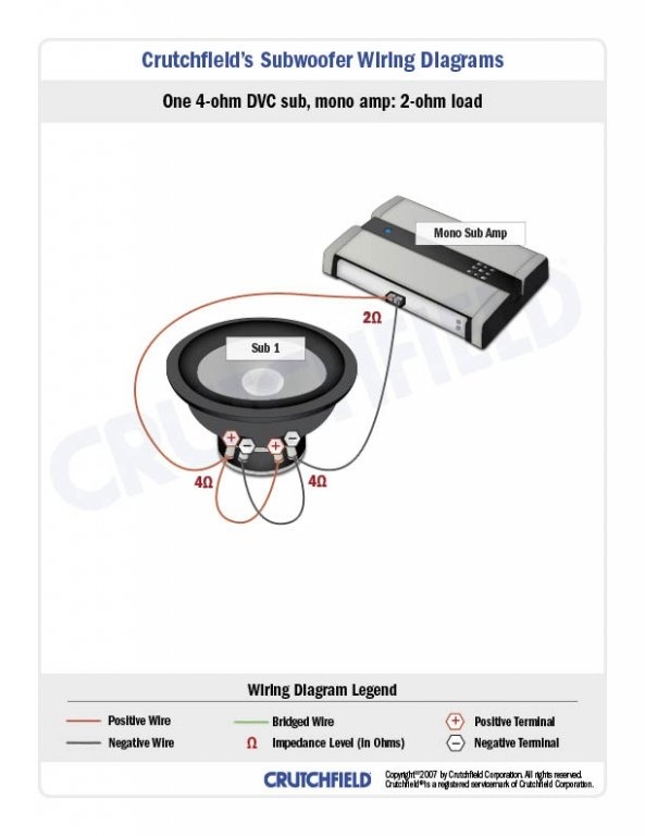

Man, there's a lot more to this stuff than I thought..... watts rms, 2ohm, 4ohm, single voice coil, dual voice coil, mono amps, 2 channel, bridging......:realcrazy:. After much reading I think I have it down, I'm buying a dual 4ohm voice coil Polk 10" woofer that's 270 watts rms and a 2 ohm Fockford Fosgate 300 watt rms amp and believe this is how to properly wire it??? If I'm understanding correctly running it at 2 ohms gets the most out of it?? Am I missing anything?
You are thinking correctly. Follow the diagram and you will be good. Looks like the specs for airspace are 1.17 sqft. http://www.polkaudio.com/db1040dvc/d/1084

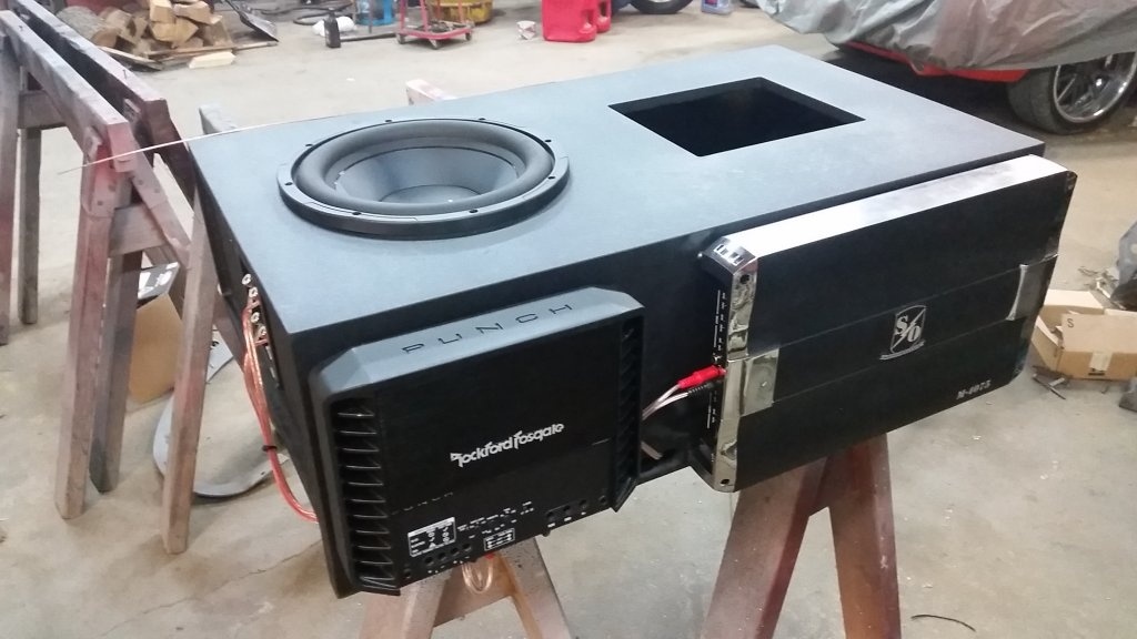

Finally finished the install, ended up having to build my own box... that combined with not having any time drug it out. Anyways here it is, I needed the box wider than normal for neatly mounting the amps on the back so why not a compartment for routing and storing the excess RCA wires, etc. I hit the dimensions on the money getting the recommended cubic feet and so far am very happy with it, it's louder than I'll ever be willing to crank it..
This box fit's neatly on top of the rear axle hump underneath the package tray taking up no trunk space too.
Is that open cavity your port?
No, I wanted both amps mounted facing back so I could easily adjust them so the box was made wide enough for both to fit back there. The speaker box is sealed and then a compartment beside it (the square hole) for wire routing and storage. It works out nice for keeping the wires cleaned up and has entrance and exit holes for routing wires out of sight. The speaker box is .66 cubic feet sealed for clean bass, it really finished off the sterio well.
