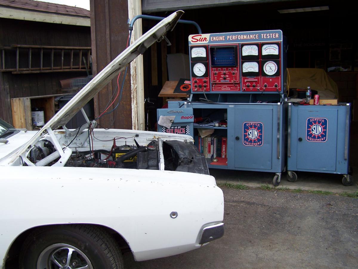

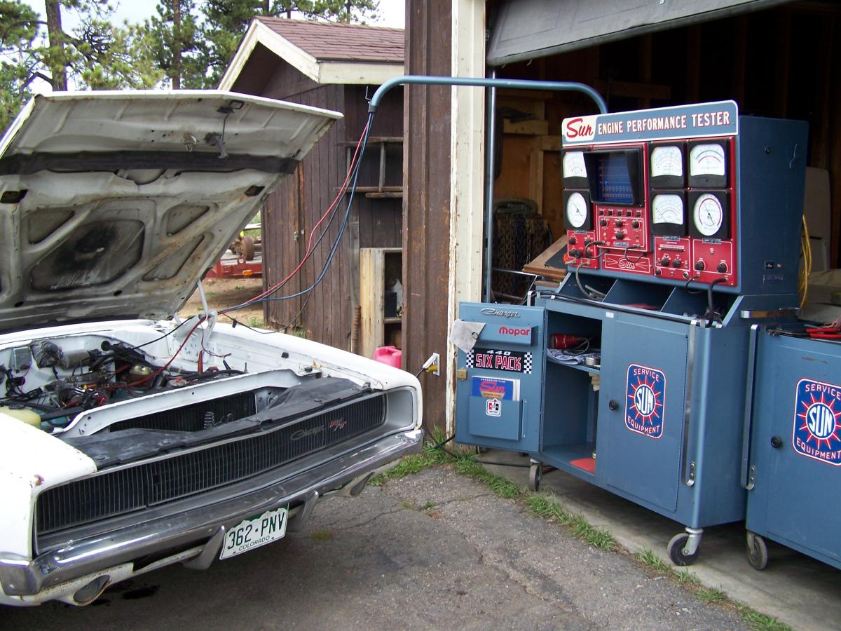

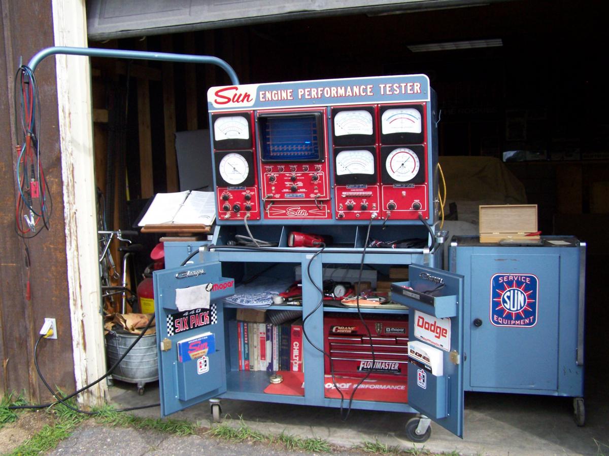

I picked up this 1974 Sun 1160 engine scope from the local Trade School for $25
everthing works perfect including the infra-red combustion analyzer and timing light. it even came with all the manuals, attachments, and
specification cabinet full of tune up cards covering virtually every make and model, foreign or domestic, from 1961 to 1974.
It made setting up the new carb on the charger a snap.
jetting, metering, choke, fast idle, idle mixture, high speed mixture,
accelerator pump all accomplished in a little over an hour. I then had time
to do a cylinder power balance review and found a slightly fouled plug in #8
and the scope showed an irregular spark pattern which led me to a worn reluctor in the distributor. Set the timing, and found a small vacuum leak in the capped off port on the carb at the end thanks to a shaky guage needle.
1 afternoon and 1 test drive and I was good to go.
car runs fabulous, and I am getting a solid 17 mpg highway out of a 383
magnum with an automatic.
It took me right back to high school auto shop so I had to go and do a quick burnout at the park :headbang:
