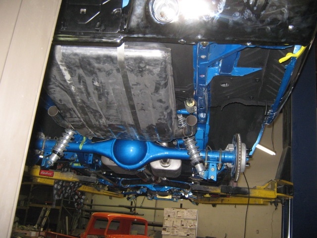

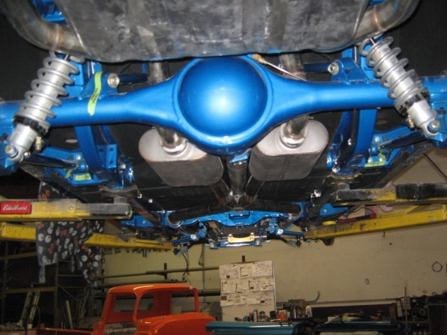

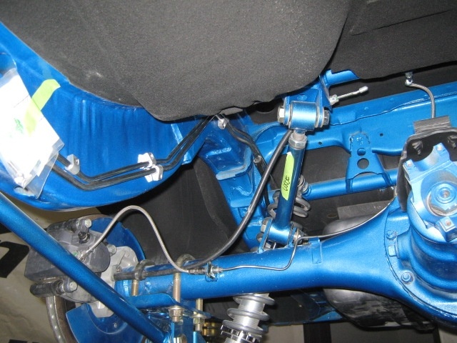

Got a pic of the coil over mount? If it isn't rigid enough maybe it's flexing and hitting the floor? I think I'd put it on a lift and jack the rear up looking for slop in the coil over attaching points, flex in the crossmember and check clearances. Do you still have a pinion snubber installed that could be hitting the floor? I know with my car being lowered I had to raise my tunnel as well but that makes a pretty unique sound:realcrazy:. Just throwing ideas out there.
Here are the best 3 shots I can find at the moment.
Nothing was showing any wear other than the bushings themselves. If I replace the shocks,I would need a coil over type shock assembly for certain.
