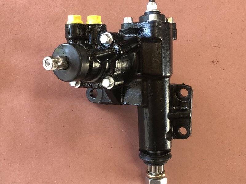

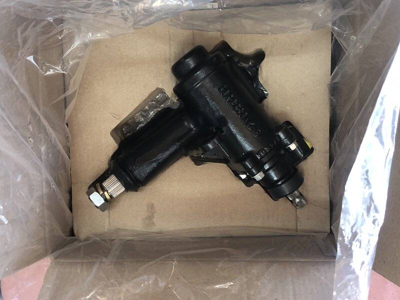

Jeez, this thing is tiny.
View attachment 1289129 View attachment 1289127
Cool. A friend of mine has installed a few of those now....much lighter weight and more compact than the standard power steering units.

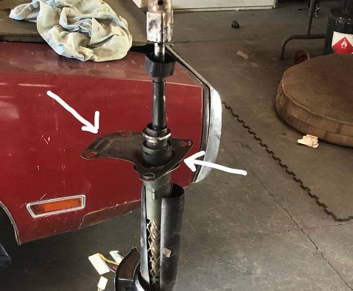

As I mentioned, I've had the column out of the car a few times. In doing so, I must have lost the foam seal that goes here:
Reproductions are available but going into a 4 day weekend means that I wouldn't get it for well over a week or more. I made one out of some 3/16" foam sheet I had in the attic. I suspect that this will in some small way aid in the reduction of road noise and such. Last month I went on a 900 mile car show road trip and although there were no breakdowns, the road noise at freeway speeds was something I've wanted to reduce.
