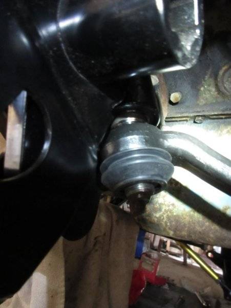

Here it is with it's cute little bootie -
The bootie doesn't cover the end threads, and it doesn't seal up tight on the nut, but it looks like it's there to do something.

Your cute little bootie is in the wrong place... It doesn't protect the nut... It keeps debris out of the lower seal on the steering box.. It goes above the pitman arm...
Well that's why I asked earlier, but it's not too late to fix it.

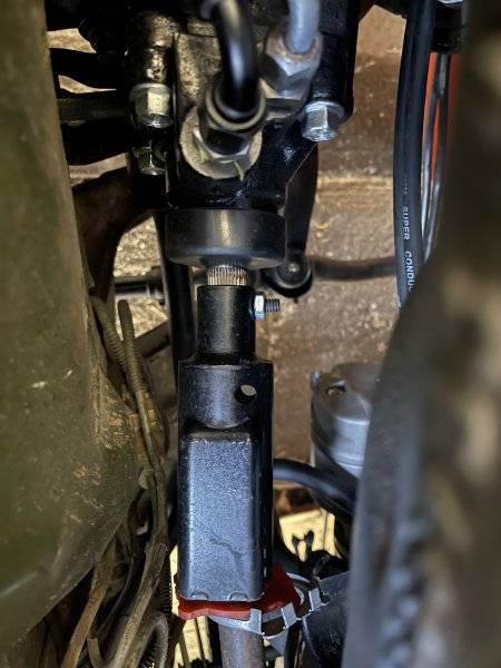

Hello,
Great thread for Borgeson conversions. On to my own: I had a local Mopar mechanic install one of Peters complete kits into my 69 Runner. I did not take pictures post installation but while at a recent car show
I noted the presence of an empty hole in the coupler. Now I'm uncertain whether there is supposed to be a roller pin (or similar) at that location. Can anyone confirm if this looks correct? (I'm aware of the loose dust cover - a steel retainer is on the way to fix that problem).
Feedback appreciated.

That's where a roll pin was originally used... Not used anymore.... Your good..
The roll pin will not be needed since the coupler is secured with the set screw.
The mechanic forgot to secure the seal and retainer clip at the other end.
