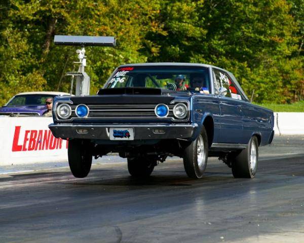

My Belvedere had Caltrac mono leafs, bars and QA-1 shocks. Stock wheel wells, 9 inch slicks, rear seat and a stock fuel tank. Registered in CT (driven to cruise nights and car shows) and raced as well. Best of 9.88@135. Granted it wasn't a road race car but it had great street manners and wasn't cut up. Enjoy your car and build it the way you want.
