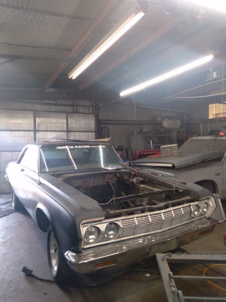

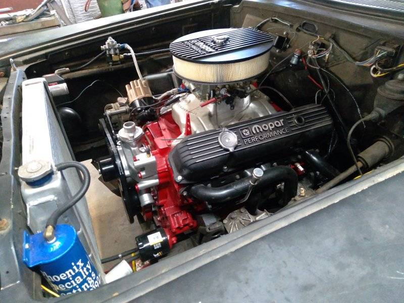

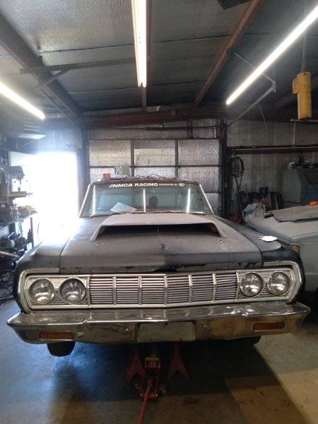

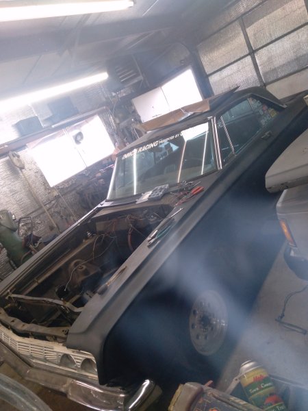

The car is a 1964 Fury with a 440. The only place to mount the tach is on the dash.
Where did you run the cable? It needs a healthy opening (5/8"?) but drilling a big hole through the dashboard is something I'd rather avoid if possible. I'd love to see how you guys did yours.
Here's a few pics of the car simply because I know how you are. :carrot:Thanks for any input and pictures might have!

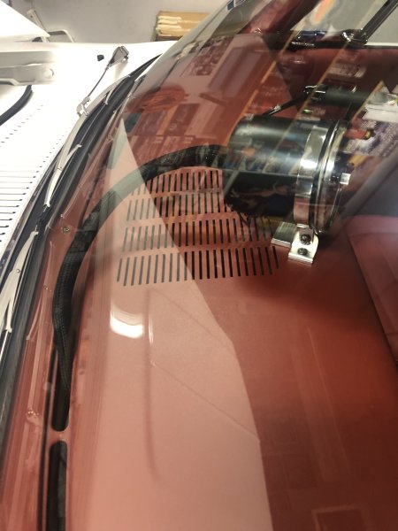

My tach cable runs through an existing hole in the firewall just left of the mc, then through the defrost vent.
I took the end off the cable to route it to the tach then reinstalled the end.
I used a sleeve to clean up the tach cable, shift light wires and tach light wire.
