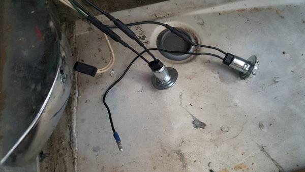

Replacing a couple of lenses leads to a total refurbished taillight system.

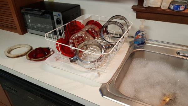

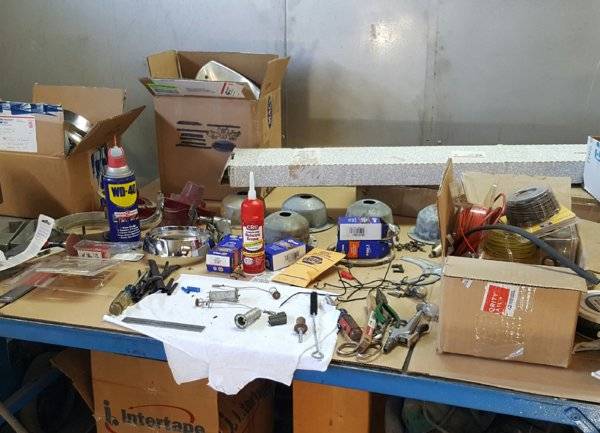

Cleaned all of the lenses that I needed. Cleaned and painted the taillight housings with aluminum. Cleaned and polished the best bensils.

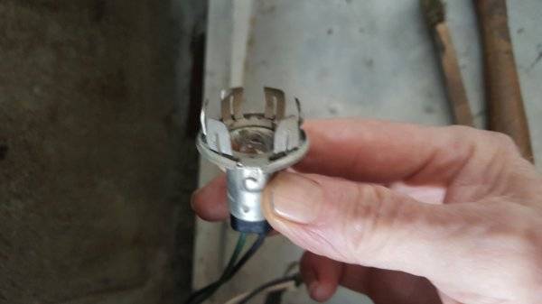

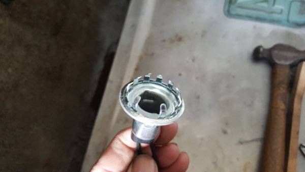

Replaced all of the sockets with aftermarket ones. Had to break off one of the fingers to fit the tab that's in the housing.

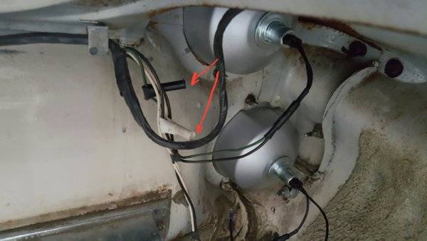

Wiring is pretty simple. Just match up the socket with the original for the correct bulb pin orientation and color of wire.

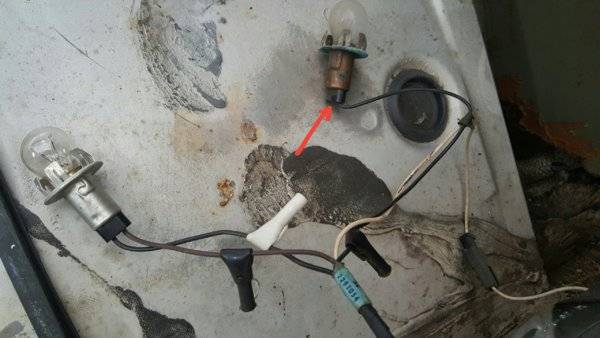

I'm thinking this harness has provisions for a trailer light package. Notice the female connectors inline for each wire. (Red arrows)
Another interesting find is that the lower light uses a double filament bulb but is wired for the parking light filament only.

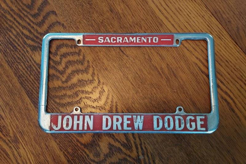

Bought the Polara a Christmas present. Original dealership where she was sold new.
John Drew only sold Dodge for a few years before going to Chevrolet. Quite rare to find such an item. I've been watching for one for years. Another mission accomplished.

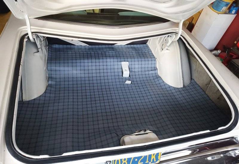

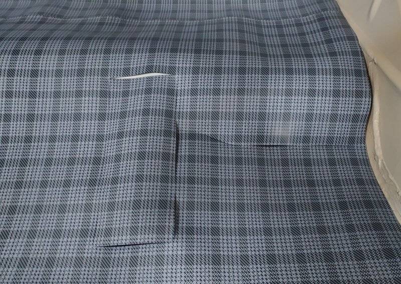

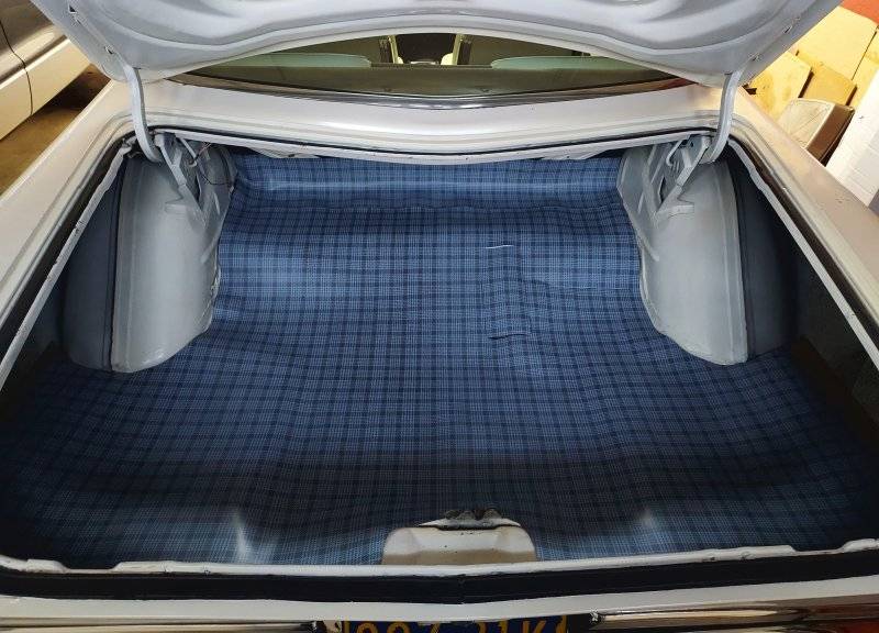

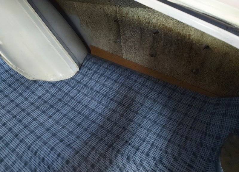

Ordered a trunk mat from Classic Industries, seven days transit. Received Friday. It was listed as a 1962 Plymouth Fury/Sport and stated it was molded. That's the main reason I chose this one. I know of two patterns they used with the '62 B bodies. A "Hash" print and a "Plaid" print. There was no mat when I bought the car so it could have been either one. This particular mat stated "Molded" that's why I went with the Plaid. The other curiosity I had was whether a Plymouth mat would be the same as a Dodge. Some patterns were available for Plymouth and not Dodge. Some molded rubber some not. Anyway here's my findings on this mat.

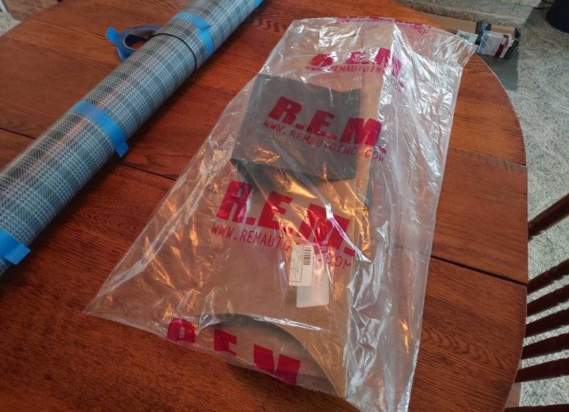

Arrived in seven days from California to Pennsylvania UPS.
Removed it from the box, reversed the roll up so the pattern was showing. Taped it up to reform for easier installation.

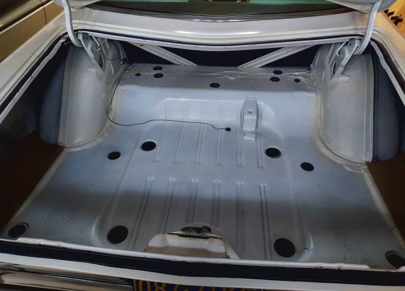

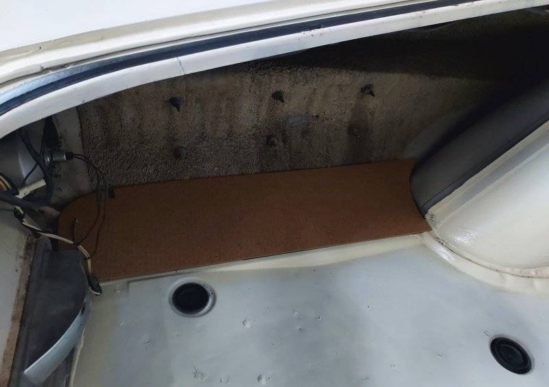

I had purchased the trunk filler boards years ago from REM. Installed them first.
After warming up the garage a little I installed the mat to see how it fit.
Molded?
Seemed to fit ok, could have been a little wider behind the fender wells but I've seen others that had the cardboard sides and that's as far as the mat went.
Here's a picture of a Plymouth with aftermarket mat. It has the cardboard sides.
Here's a Dodge with a aftermarket mat.
So what do you do? It's a trunk mat. Being the same as a Dodge mat? Looks pretty close to me. The spare tire bracket cutout is in the right location but they cut a line all the way to the outside???
Plenty of extra material front and back. Looks like maybe the Plymouth braces are in a different location looking at the notch in the mat?
Anyway after about ten minutes in the 50 deg shop the mat was cold and a bit stiff. Will fine tune this on a warmer day. I can live with this mat.
Much better than the ones that come folded.
I would suggest buying a molded one from ACC. I don't think REM (the one i bought) even has molded ones. I had it out in the 65* weather today along with a heat gun and was able to get some shape into the mat but not much. Also did some trimming to fit. It will have to do...
Installed the dealer tag frame also...
Looks great, although that rust free floor looks pretty darn fantastic.
I think I posted pics of my original mat before. It was molded around the filler by partially stamping through it in a halfmoon pattern, so it laid on top of the raised section, and was lower on the trunk floor.
Had multiple other stampings at the rear, a few did not fully separate, and the ones that did were still in the trunk.
I'd have to look at it again, but it may be cut from the spare mount to the edge, and iirc the mount hole was 1 rectangle.
If it wasn't molded originally, it became molded due to the weight of the thickness of it.
