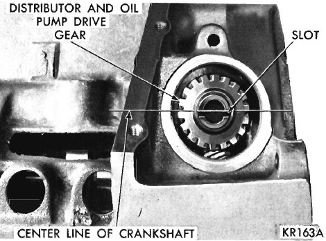

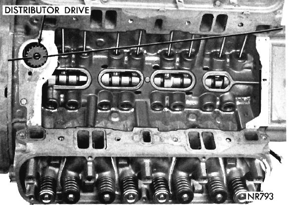

2---After the cam is timed, with the timing marks on TDC, the "book" shows how to insert the intermediate shaft. if yours is incorrect and you want to correct it, you can simply use a large screwdriver and "walk" the gear up out of the helix and move it whichever way it needs
The gear on a small block should have the slot pointing nearly straight inline with the crank, just a tad to the driver side pointing at the front most manifold bolt
A B/RB gear the slot should be essentially inline with the crank

The drawings show proper orientation of the drive gear for small and B/RB engines

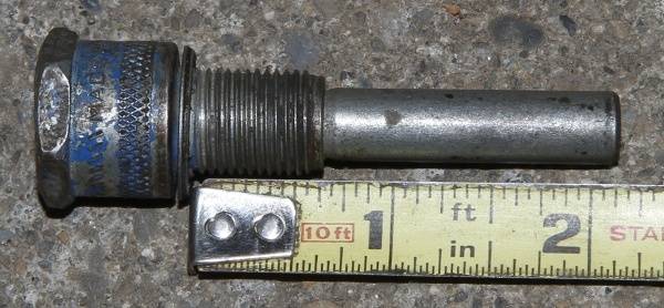

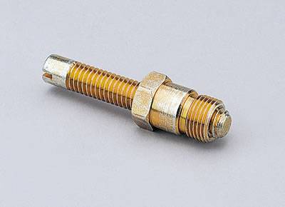

How do u make a piston stop? I.E. how long? That sorta thing?
You can buy them at Summit, surely at Jegs
Just went through this at FABO the other day
NOTE this one is for small block, don't remember the length ya need for B/RB

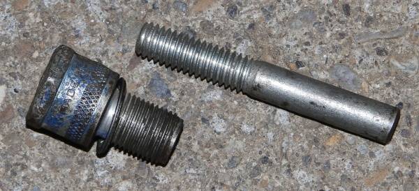

Take a spark plug, and carefully saw all the way around the crimp. Cut off the ground, and use a punch or junk bolt to drive the guts out of the shell.
Then tap the shell for a 3/8 bolt. If you don't have a tap, drill/ ream the hole a little so you can slip a bolt in there and tack weld it. Leave plenty so you can trim it to length. You are not trying to stop the piston at TDC, but rather "down in the hole" some distance. Exact distance is not important. IMPORTANT thing is that the stem is a reasonable length and RIGID so it won't move.
Here's one I built over 30 years ago!!! The bolt as measured from the gasket surface is about 2 3/16, not critical.
Be sure to round the edges of the bolt off a little, so you don't put "nicks" in the piston dome
If you're thinking of buying a decent camshaft degree kit, it will have one in it. I got a Comp Cams kit and it's a nice one. I already had everything to do it, but my dial indicator was like a 1941 model. Although still accurate, It has sentimental value so I retired it and just got a whole kit. You can find them for under 100 bucks if you shop around. It has a deestruckshunal video and all. It's nice to have it all in one spot.
