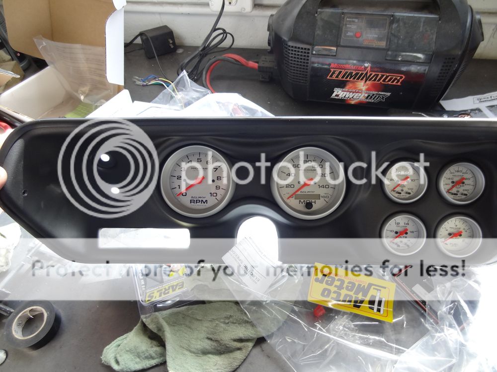

With the added amperage in the Alternator and the custom audio in the trunk, the factory gauges were not cutting it, so a B Body insert from Classic Dash and Auto Meter Ultra Lites in Purple back lit LED's is a great addition as well as a more reliable setup.

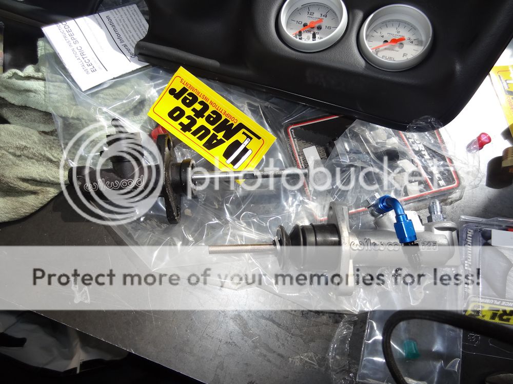

Smaller slave cylinder for the hydraulic clutch should save my leg and make pedal effort much better for that stop and go traffic!

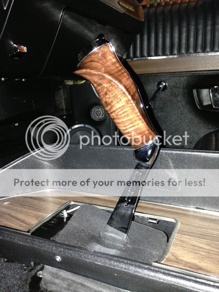

Nice looking Tiger Stripe Maple Pistol Grips. Much improved from the factory plastic. Nothing feels like wood!

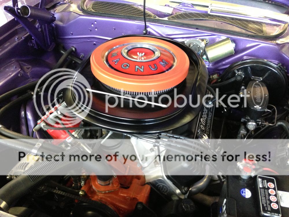

Even though I am short the N96 hood, I have always loved the N96 Air Cleaner. Big improvement!

Curious where you got the tiger stripe pistol grip inserts? I have some ideas for my shifter and those may need to play a part :)
There is a guy on the Cuda Challenger form that makes them. I believe he is in Ontario so not far from you.
Thanks! I think I found him doing a search right after I posted this. My problem is that my shifter won't be able to be a generic fit from another model and it looks like he only sells complete units. (doesn't sell handle separately) OH well Bummer for me!
I also just came across this http://www.idlehandswoodwork.com/
