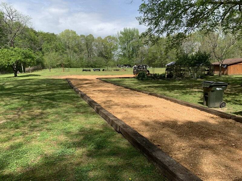

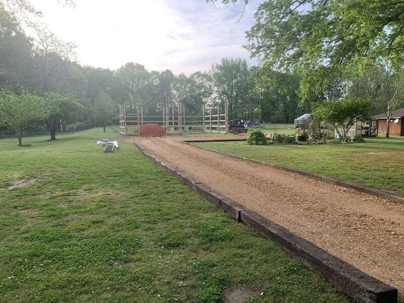

The shop build has not really taken off just yet due to the really wet and rainy weather as of lately. We just now got the base for the drive in and hopefully the corner posts for the shop will be in the ground soon.

Just a question. Based on the picture shown of the driveway being above the surrounding ground, how will water flow from one side of the driveway to the other? If the grade on both sides is downhill parallel to the drive it will not be a problem. Be careful about creating dams to trap water.
Thanks Coronet, Arch! This area of the property is really level and there isn't any standing or flow of rainwater to contend with. There is also a slight incline you might have noticed leading up to the actual build site of the shop that should work out in my favor if we were to have some abnormally heavy rainfall.

I've had to reconfigure the driveway to allow room for the concrete truck to get back to the site. The turn was going to be too sharp before the re-do.

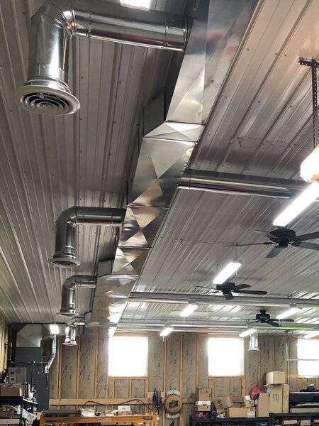

I'm not very concerned with cooling my shop but will have a fan on hand to help with the draft. I have decided on electric heat at this point but that could change.
That duct work screams "I Own An A/C Company...."
Well, that... Or My A/C contractor loves me... :lol:
Very Nice...
I'm working on adding A/C to my shop.. But I'm not an A/C contractor & nobody loves me...:mad:
actually my AC contractor needs a engine built! :rofl::rofl:
