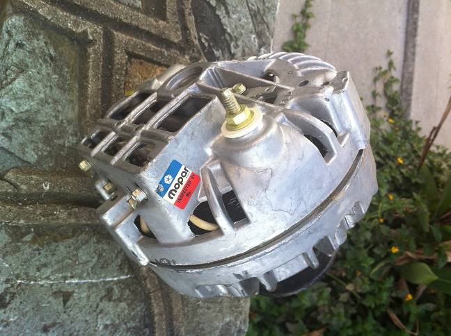

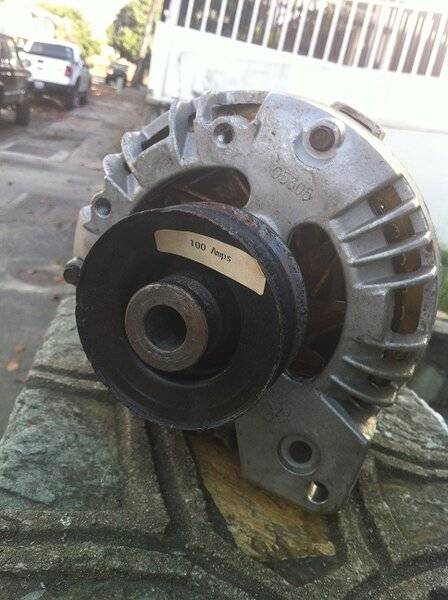

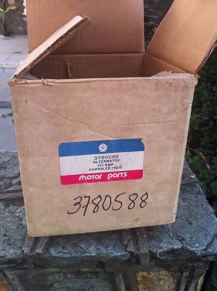

well I have being running 80 amps alt ( althought it got a decal saying is 100 amps, but seriouslly doub it, changed for the smaller pulley too ) into a 40 amps amm system with the correct bulkhead upgrade FOR YEARS on a daily driver car ( REALLY daily driver ) with AC, halogen headlamps and my ammeter is quite peacefully death centered 85% of the time ( using A/C, lights... and sometimes even wipers but as far AC is on low speed ), cool and safe. And sooner or later will upgrade it for a more powerfull alt to be able to run mid or high AC speed with wipers and lights, stopped at a traffic light and I'm confident on my system.
but.... you don't trust on my experience nor my words. Maybe I don't have a Car in fact and just like to make diagrams and explanations for fun to get the comunity confused LOL!!! You are saying more less what I have done on my car is actually a fake!
I just can say, I'm not inventing my proceedment. Is not an imagination product, is an experienced, tested and daily applied and running setup.
Untill those who don't believe it prove it by yourself. But maybe need to be brave to make it LOL
I'm not saying on YOUR SETUP will be better keep it or not, but as mentioned by 72RoadrunnerGTX, on 80-90% of the cases, this kind of care and upgrades are quite enough. But the red flags jumping out around happilly are more than the reasoning opinions based on actual experiences and not just fears coming from the unknown ( as usually all the fears come from ) LOL.
I'd like just to keep stopping the red flags from where they are not necesary

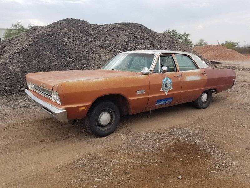

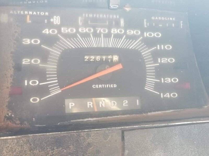

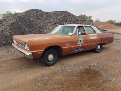

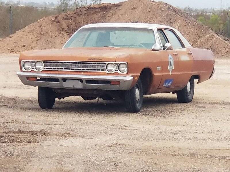

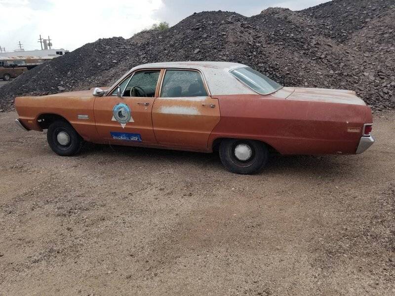

Check out this 1969 Plymouth Fury I Police Car. It's rumored that, back in the day, this exact cop car chased that dilapidated 1971 Hemi Challenger that was recently discovered in a backyard in Tucson. The Challenger has been sold, but this cop car is available sale, also in Tucson!

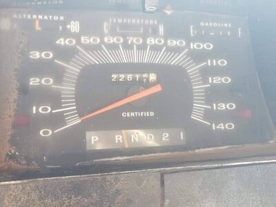

Why am I bringing this up in the Ammeter thread? Well, check out this Fury's instrument cluster.. 35 Amp Ammeter myth busted! You can clearly see this Cochise County Sheriff's Fury has a factory Ammeter "Alternator" gauge that is marked -60 to +60 Amps! Almost double the mythical, unproved 35 Amp rating that has been stated in this thread. It also has a "certified" 140 mph speedometer. They weren't ******* around with this Fury!
I bet it chased down a lot of bad hombres in it's prime!
