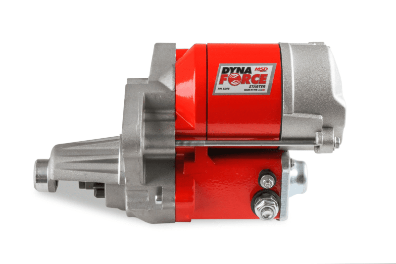

building 540 hemi any suggestions on old school mopar starter possible year can get rebuilt local that will turn motor 9.8 compression
thanks
Lightweight Denso style starter will turn that pup over easily, but if you're bent on old school stock type starters, I'm sure that all year starters can do the job, just be ready to carry the extra load of 9-1/4 Lbs. My stock style starter weighed 16 -1/4 pounds and my new style lightweight starter weighs 5-1/2 pounds.
I've got a genuine Mopar performance mini starter on the shelf. Using the original stock style starter. The ancient hooker adjustables im using have a tube going right thru where the mini has to be. The 10 ton stocker fits perfectly. Sob.
Odd that the Titanic stocker fits in that space with the header tube and not the SS MINInow which would take up less real estate.
It seems the solenoid for the mini sticks out farther towards the fender, where the old schools is right on top. There were no minis when hooker built these headers.

V8 Dakota starter 5.2ltr/5.9ltr Magnum (mini/compact) works great,
44:1 reduction,
it'll spin that thing like no tomorrow
had several of them on 12.9:1 & 11:1 compression 479cid+ B-series motors
& probably (? I assume) less than 1/2 the weight of the big *** iron OE Hemi
or even the std starter on a org. 68-383cid 335hp RR engine
(I'm not **** enough to actually weigh the differences)
relatively inexpensive too
on the factory Dakota replacement starter
for a 1999 Dakota SLT 318/5.2ltr magnum (IIRC)
I had to trim the 'main 1/4-20 threaded 12vt post'
as to not contact the block, (like a 3/16"-1/4" off, need to check it when installing)
that stud's length is unnecessary on my B-low deck block
without buying some conversion deal to make it go 90*s
they also make like PowerMaster (or other brands)
of mini Dakota Magnum style starters
that can be clocked at like several different angles, for twice the $$
"I think" they are a tad bit lighter than the OE 5.2/5.9ltr Magnum starter,
don't quote me on that, just an observation
Yes, the "90s" Dakota mini starters have been "the" inexpensive great working small starter substitute for the "Hoover Dam Hydro-Electric Turbine" full sized dynamo Chrysler engineers laid on the Mopar Nation, and they intentionally made it "sound funny" too!

I tried the Dakota starter route only a couple of years after I bought my 440 6bbl Roadrunner and the damn thing didn't fit. It's been years ago, but I know the factory starter wires (molded together on the starter end) and the often mentioned way the posts on the connection block on the starter itself either touch the block or are SO close to the block it's WAY too risky to use IMO, add in the heavy guage starter + power wire and I "opted out". The power block adapter that's so popular may make all that better, but I went with the MSD Red mini starter and it's been great since I installed it appx 5 years ago.
MSD DYNAFORCE STARTER - HIGH TORQUE - RED

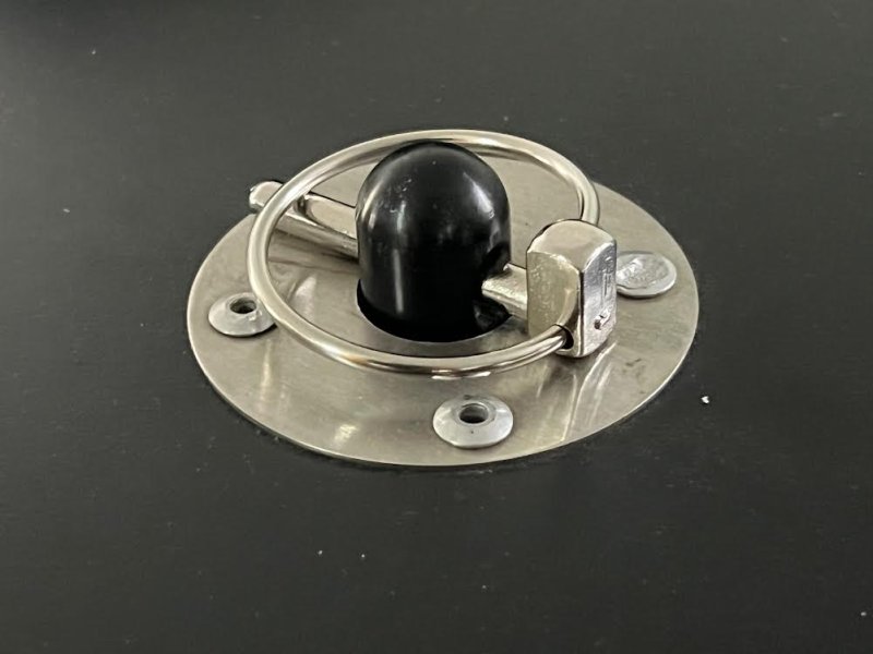

One more and last thing on the subject of hoods. These skid plates come in two materials: polished stainless steel and aluminum. When you are talking four of these on each corner or more at other locations throughout the hood, it adds up. Yeah, every ounce counts up top and front.

Dont forget. The main pin itself can be aluminum.
Amazon product ASIN B003BZQ8U2
Yes, the pins can be aluminum. Moroso makes a set but are too thin for my taste, so the Ring Brothers or Wood Brothers aluminum pins are more beefy and come in satin black.
Here's the super duty Ring Brothers hood pins on a mysterious Dodge. Aluminum with a steel rotating bearing hole inside. Still lighter than steel hood pins. Very nice piece.
Here's the super duty Ring Brothers hood pins on a mysterious Dodge. Aluminum with a steel rotating bearing hole inside. Still lighter than a steel hood pin. Very nice piece.

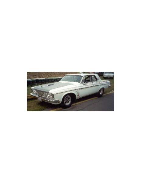

This lightweight Plymouth being tested out west most likely at Pomona is one of the four 2% cars complete with a thin gauge radiator crossmember and Magnesium front Pizza cutter rims. Note the Max wedge scoop as a stand in for the yet to be delivered Hemi scoop.
