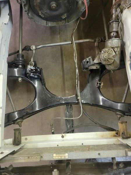

What are we looking for in this Rem? Are those pinched continental shelves gone?
Yes sir. Iirc it went from 38 to 22. But it's getting close to 20 years ago now..
Took out some unnecessary gusseting as well
Dammn, that's a good fat trim if I ever seen one. Wish I would have done it, but I was impatient. I did get rid of the motor mounts and some gussets though. Next time I have either the engine and or ignition system out of the car, I'mma going trimming and sealing. Much better either when the K is off the car or on a lift with a good Tig welder juiced on the side.

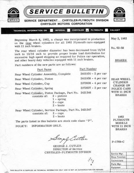

Badvert. With a smaller bore compared to the 15/16 bore of a Mopar unit, will the pressure at the rear wheels be less?
I think the pressure would be less. I have front disk brakes and there was a service bulletin about using smaller wheel cylinders on the rear drums. Smaller than the original 15/16" ones. Chrysler went with the 13/16" to reduce the tendency of rear wheel lock up. The bulletin was geared toward the police car applications.
I have been using the 13/16" bore rear wheel cylinders on all my cars without problems.
Interesting. So Chrysler actually made 13/16 units for Police services only or all across the board? I thought they were all 15/16 as far as the rears.

RemCharger,
Yours looks a bit skinny compared to mine!
It shows on the scale with me at -12LBS and your at -16LBS! CONGRATS!!

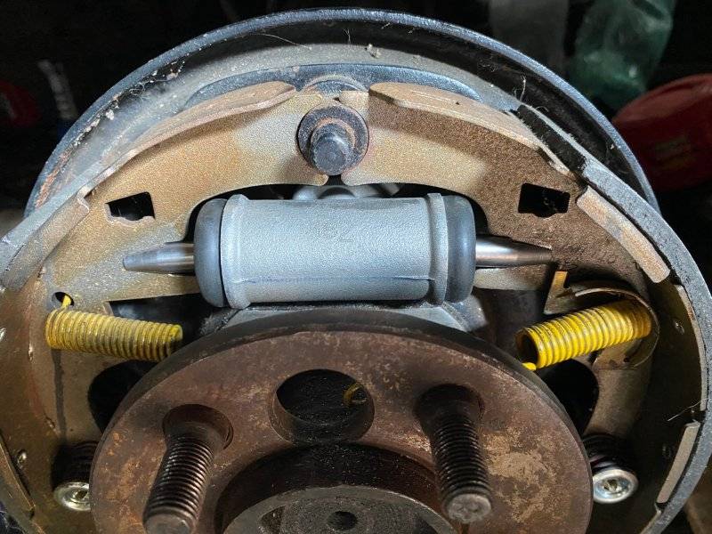

I put 13/16 rear wheel cylinders on my Belvedere years ago and have always had great brakes. I am now going to replace them with the aluminum version. I have a pair of the 13/16" aluminum cylinders installed already and just have to wait until I get the car's floor welded in and the engine back in.
View attachment 1718039View attachment 1718042
What size are these brakes 10" or 11"?
Is the cylinder in this picture above aluminum? It sure does look like it.

That's what I thought. Gonna look further into this by purchasing one aluminum unit and studying what you have done.
