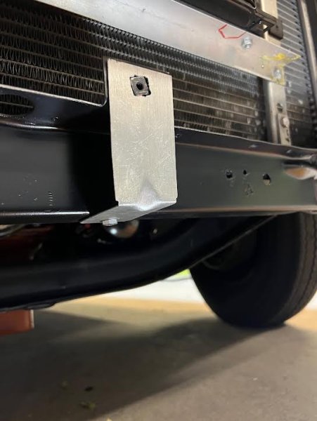

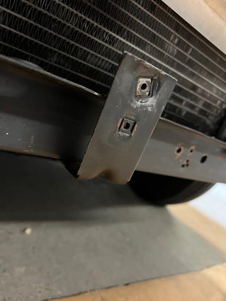

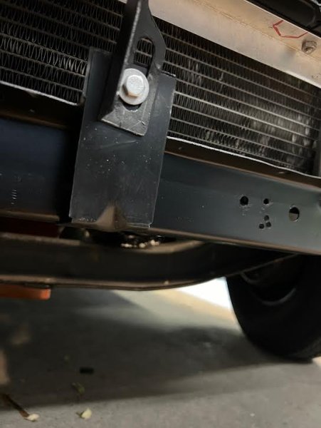

So I made a little time tonight to remove the steel radiator core to vertical support brace. It's basically an L shape thingy with a strengthening dimple on the crest of the 90 degree bend. Here it is in the stock mounting location.

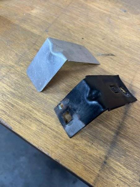

After removing it, I weighed it against its new aluminum sibling. The steel weighed exactly 1/4 Lb. The aluminum one weighed 3 ounces.
You sound like a politician or tv huckster using 2 different terms to make the difference sounds bigger than it is. You lost 1 ounce on that bracket, correct?
I’m not knocking your efforts, it just struck me as late night infomercial speak.
