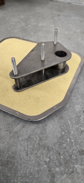

Yes. I once fabricated an aluminum pinion snubber that lasted quite a few years under there getting beat to ****. I guess the boxed aluminum snubber tower was strong enough being that the forces were wedging it against the floor. Took it off once I went Dana. Sold it to a local guy with a Roadrunner who then never used it.
Got any pics of that aluminum pinion snubber? I was just considering making one this past weekend.
Unfortunately, no. It was one of those fluke creations with extra aluminum material that I had hanging around.
I used a boxed aluminum tube stock and welded it to an aluminum plate the same thickness of the steel one. Drilled the three holes for mounting to the rear chunk and let it do its thing. The bumper sat and was bolted to a flat aluminum plate welded to the box tubing. Access to the bolt and nut was from underneath. It was non adjustable though, so it was measured to act and perform to the cars ride height. It looked totally stock.

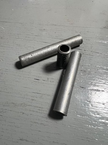

Here's an example of some aluminum hollow tubing that you can find either in a good metal surplus spot or maybe even at Home Depot. It's best to get a tube with an ID snug to the bolt shank size being used which in this case a 3/8 thick and a thick outer wall to prevent deformation or collapse.

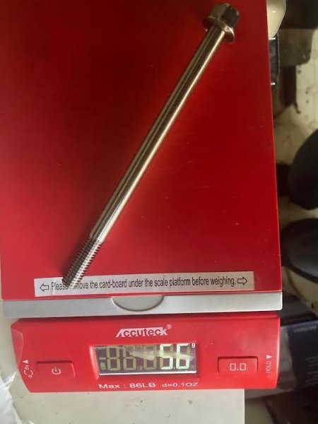

You got me beat, mine weighs 1.86 ounces. The gods of weights and mass must love you more.
Yeah, the Gods didn't like that I didn't want to do all the heavy lifting before, so they went heavy on me at the pearly gates and I fell back to earth. I promised I'd do the lifting next time around, but little did they know that everything I touch will be light. LOL.

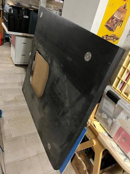

I told him about one of my first attempts at removing weight from my steel hood at the time. Basically, gutting the entire underbelly structure and leaving only the top skin and its sidings which gave it strength. Flimsy it would end up being, especially with the carb hole cut out, but it would stiffen and straighten right up with the addition of the Hemi scoop.
Here it is in storage with the carb hole cut out of it sans the Hemi A-990 scoop. As you see it, it weighs 34 Lbs from its original factory 79 or so Lbs.
It was held on the the car with the usual 4 corner pin setup.
Eventually I went batshit and fabricated the whole hood and A/FX scoop entirely out of aluminum while using this steel hood as a measuring guide and template.

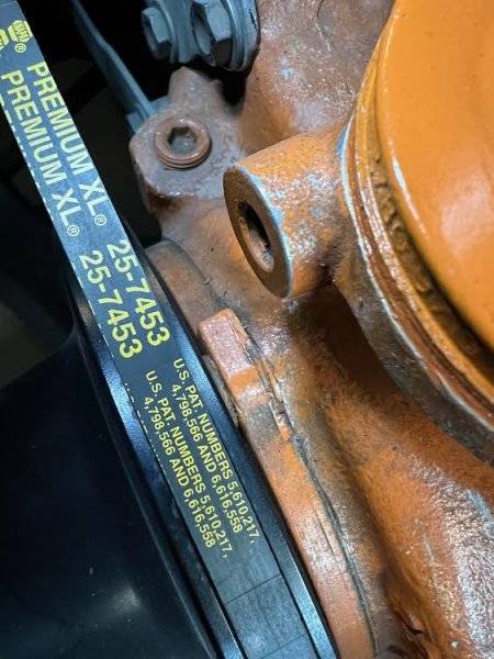

The other day, I noticed that my main drive belt seen here (NAPA #25-7453) was a little stretched past its adjustment swing on the alternator bracket, so I decided to look into a belt about a 1/4 to 1/2" shorter to regain some tension. I ended up with a NAPA #25-7445 which was a whole 1" shorter. Obviously after installing it, I regained my tension swing and probably.......probably lost an ounce via less belt material....... but at a $20 cost for the belt.
