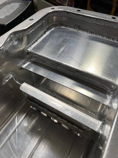

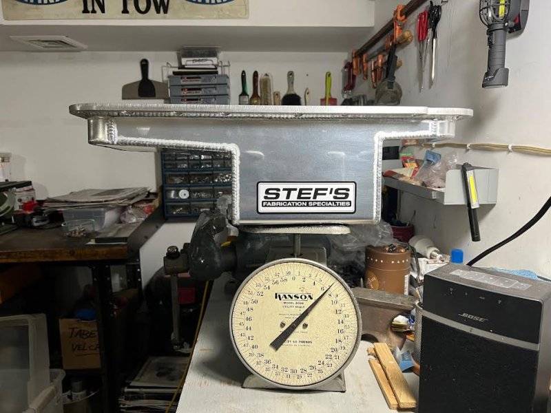

These aluminum oil pans are not as light as one would think. Contrarily, the baffles, dams and trap doors are relatively light. It is the inner and outer weld beads to Frankenstein all the break formed panels together that are partly the culprits. The pan rail such as this one with a 3/8" thickness also contributes to the weight which in this particular case is 7lbs dry. The stamped steel one will be weighed to make comparisons sometime soon. I think it will be lighter even with the same oil capacity.
I must say it is a very well made piece as one can see. I would guess oil cooling for street driving would be improved by a small amount. Obviously, the dams and doors keep the oil pumps tummy nice and full.
Identification decals will be removed to protect the not-so-innocent.

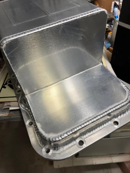

I might be lucky because it is welded both on the inside and out. Double bead.
Here's the inside weld beads. The mounting rail of course has a double beefy bead on the inside and out around its perimeter.
Here's the outer beads on every inch of the outside. I'm still going to check for any leaks and such.

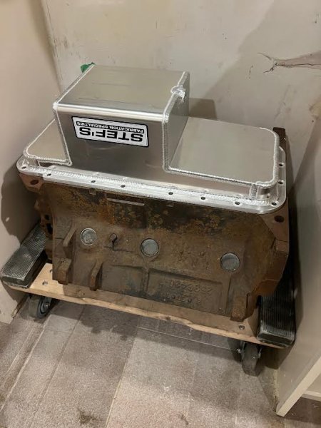

Each bolt hole has a slightly recessed drop machined into the mounting rails to seat the washers and bolts tightly. All mounting holes matched the threaded holes on the extra block.

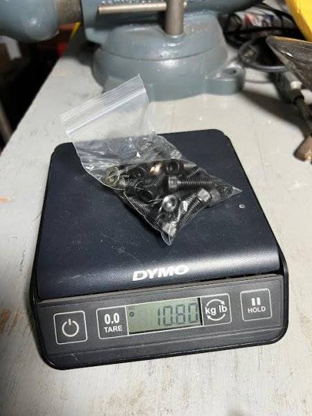

Speaking of bolts, here's the supplied bolt pack with slightly longer lengths to compensate for the beefy 3/8 mounting rail. 10.80 ounces.

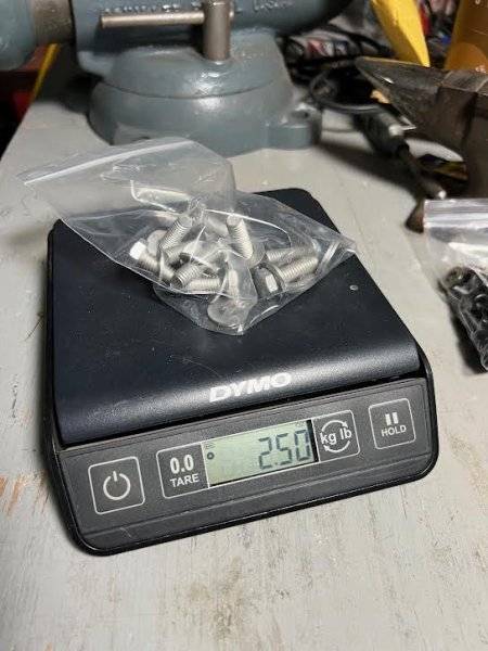

Here's FMJ's own supply of 2024-T4 aluminum pan bolts with slightly longer lengths and washers to compensate for the beefy rail.
Mind you, there's only ten bolts here (half the amount needed) which would amount to 5 ounces as a complete pack.
