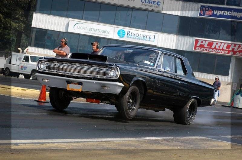

Awesome Pic :thumbsup:
Thanks. It is one of only two images that I have of the car in motion since I can't photograph it from the outside while piloting. LOL.

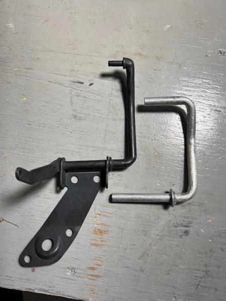

For the most part, items here have been successful in deleting weight and most importantly, operating sufficiently and safely. So here's one of the first components that while it was going really well in fabrication mode, there was an underlining concern if it would work for a long time and not collapse.
It was the throttle bracket and lever seen here. The decision was made after thinking it through in what would be a work hardening period of gradual applied pressures under normal acceleration and stomps under all out pulls........and so, it was scrapped. The factories I am sure had heaps of bins with scrapped projects that never got off the ground.
I must say, it was both challenging and yet fun in making it, but sometimes certain things are just best left alone. Look elsewhere for those ounces.

Mines broken the factory part. Right at the weld at the end of the shaft. Of course, right when I had an awesome R/T right at the starting line. Have broken cable ball studs as well. For your pan? I’d cover it with a black diaper. Kill two birds with one stone. And then you won’t have the weight of paint on the pan.

Wow! Damm Doug! talk about having a heavy lead foot. LOL
I've never seen one of those throttle levers break, cable ends yes, but not the steel lever bracket.
This one I displayed is an extra one in my inventory just in case. I bought it at first to use as a template for the aluminum one and now is just an extra.
It has a better weld now than the factory.
