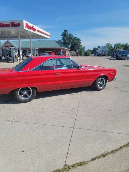

The old.... lets see some wheel pics - may be looking to swap out
Yes. The gunmetal is a powder coat, then the whole wheel is clear powdercoat.

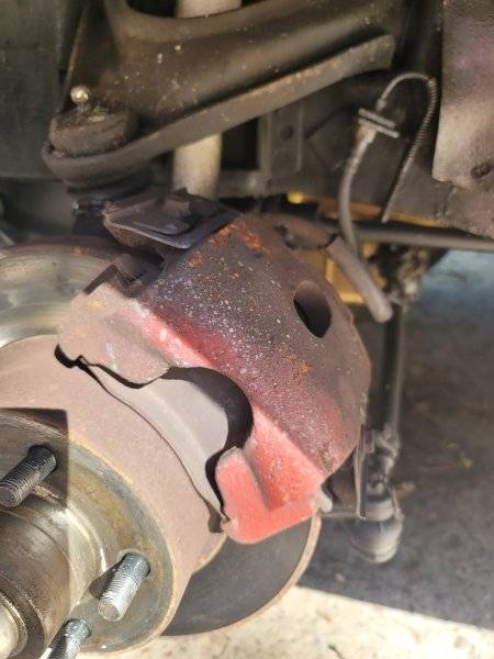

Here's at least a pic of the fronts....

Those look to be at least a half inch longer than factory 57 Chevy studs. You should be ok. Check it out, anyway...
