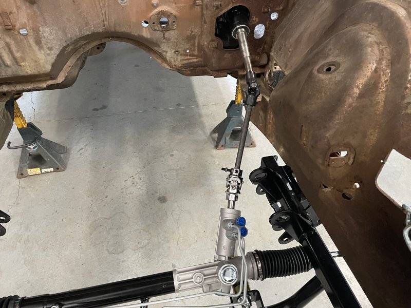

Fran: I've test fitted the engine, transmission & steering linkage. Still have to test fit the A/C-heater box & drill holes for the F&R upper door pads and tail panel trim. Stripping the paint will be the last major project before it goes to the body shop.

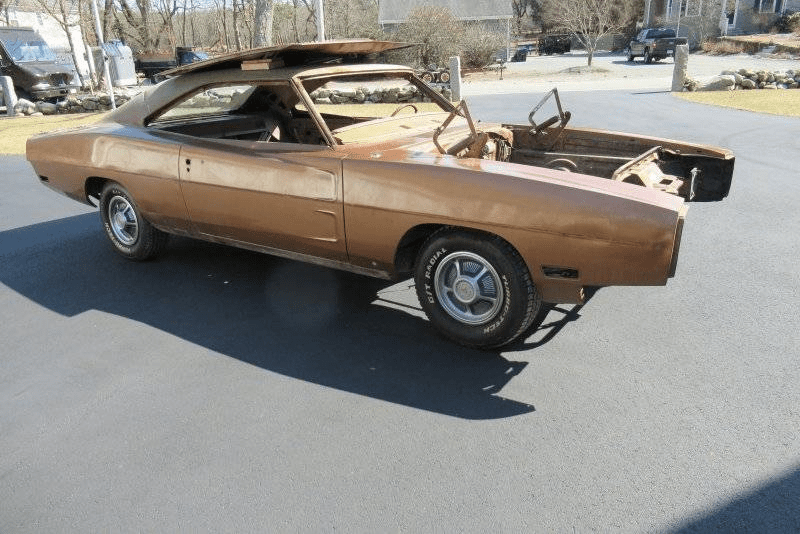

This car is the higher dollar equivalent to my "Jigsaw" Charger...
