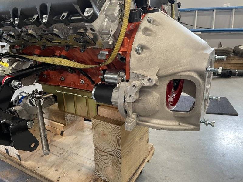

Mounted the clutch, bellhousing and starter. There is a boss on the left side of the block on the oil pan rail that needed some massaging with a grinder.
I've always said that there isn't a part on my car that I didn't have to modify somehow. It's nice to know that the modern stuff is not immune.

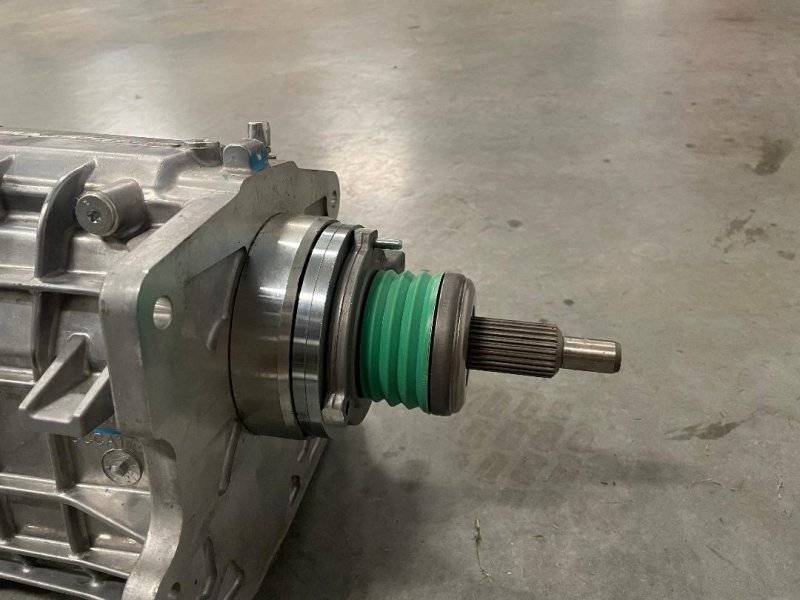

I was going to mount the transmission & hydraulic throwout bearing, but I need an additional 3/8" spacer on top of the two 1/4" factory supplied spacers for it to work properly. On order now.
Is that normal to use that many spacers.Dont know much about setup,but seems like a lot
I guess it is. The "hanger pin" has room for quite a few more. When installed, the throwout bearing should be compressed at least 1/2". As it sits, it would only be compressed about 1/4".
Yes. It is normal. It takes what it takes to give proper preload. You need some space because the clutch fingers 'grow' with rpm and if the bearing bottoms out, the fingers will actually hit it and since centrifugal force is pushing against it, the clutch will actually start to release.
Had you looked at the Macleod HTOB?
Pretty fancy billet piece. Adjustable too.

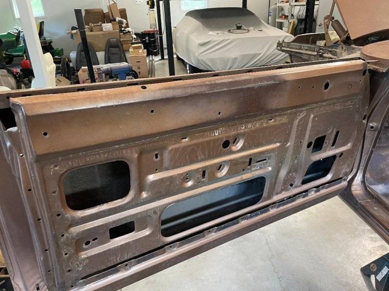

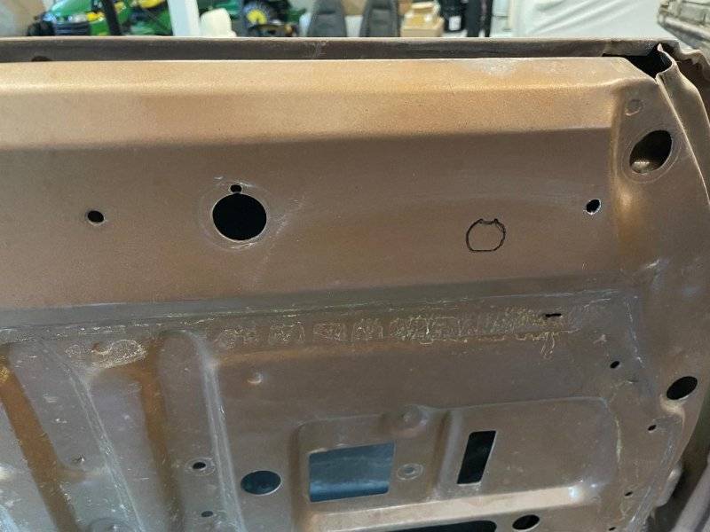

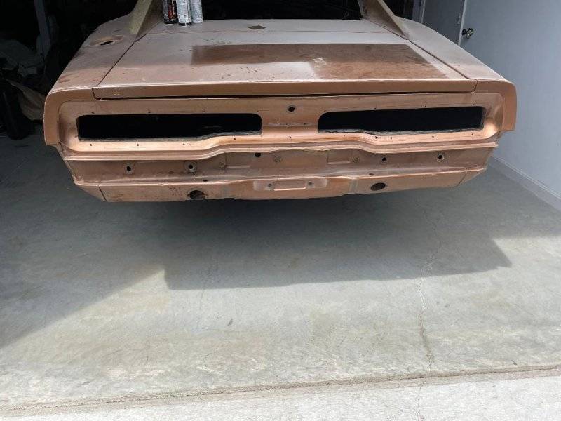

Drilled a bunch of holes today in the tail panel & also to attach the upper door pads on the inside of the two door shells.
Apparently the mirror control is in a different location whether the car came with or without upper door pads. I'll drill out the new location tomorrow.

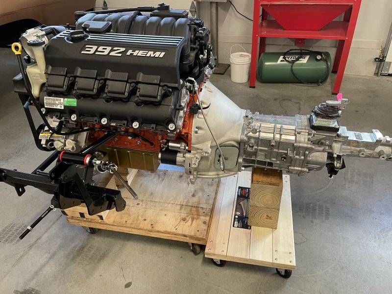

The spacer that I needed came in today so I got the transmission hooked up permanently and ran the line for the hydraulic throw out bearing.
It looks like it could fly, well done!!

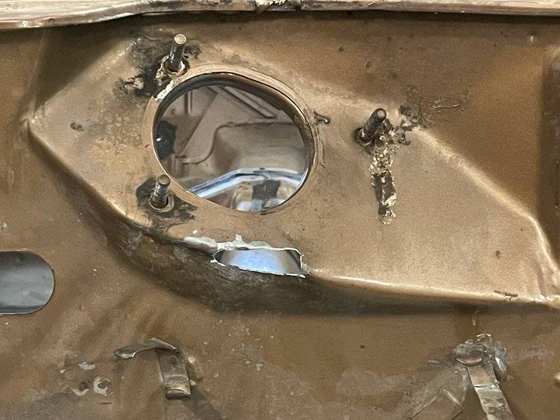

After another test fitting, there was some minor surgery needed below the wiper motor. I’ll have the body man weld in a small piece of metal. That cut out won’t bother the rotation of the wiper crank arm at all.
That's all you needed to trim. Cover it with chewing gum like factory would ! :lol:
