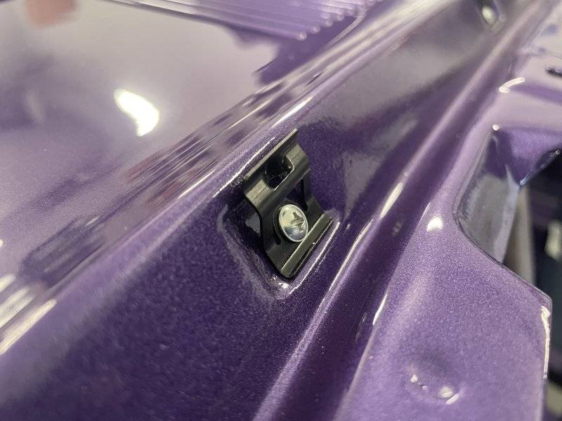

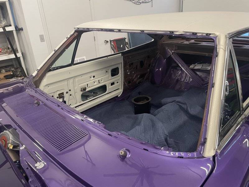

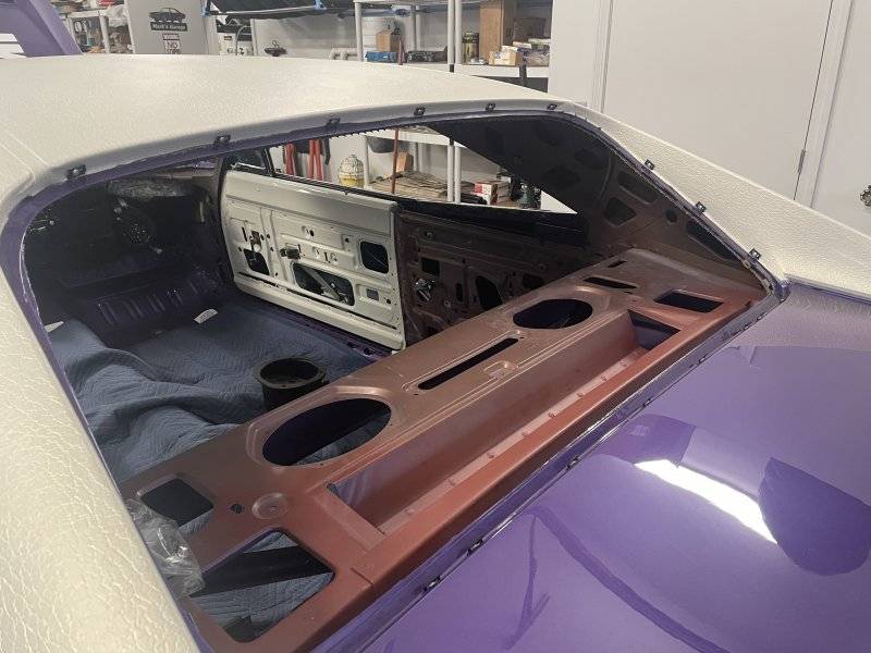

Did you use new clips or reuse the factory clips?
New clips.
A while back new clips had issues keeping the trim on. Hopefully, they fixed it.New clips.
That, and the screw heads were to tall preventing the trim to snap on. I always find NOS clips and screws, a lot less drama.A while back new clips had issues keeping the trim on. Hopefully, they fixed it.
My Coronet came loose in the corner at speeds I won't mention.That, and the screw heads were to tall preventing the trim to snap on. I always find NOS clips and screws, a lot less drama.
Yeah, the crappy ones had the goo as well. Hopefully they got the issues sorted out with the repops by now, but like Wayne stated, test fit your trim before caulking in the windshield.That doesn’t appear to be the case with mine. The screws even had that yellow wax on the tips.

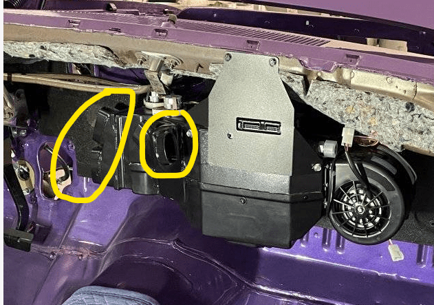

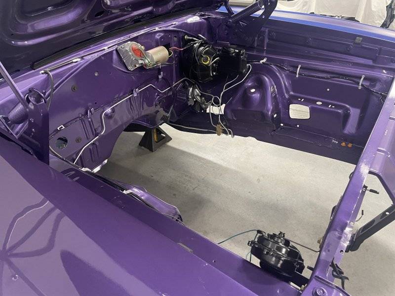

Mark, have you tried out the fitting of the flexible ducts on these outlets yet?
Mine were a real PITA to install. Round duct and slightly to large diameter of duct outlet.
If not already done, please try it before you close in the dash any further.
Maybe Vintage have changed things since I installed mine.....maybe not.![]()
383 Charger??I had to put a new fill tube donut gasket in my 383 Charger so nothing too heavy duty was done today, just F&R windshield clips.

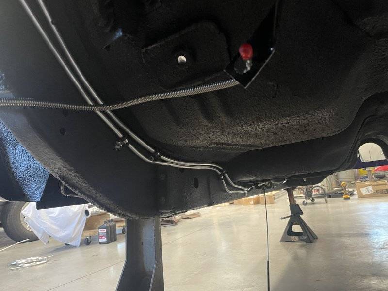

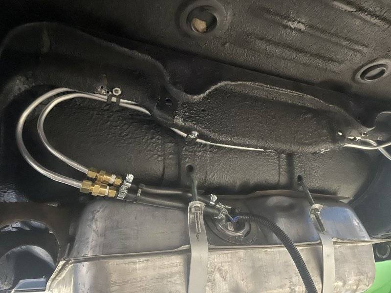

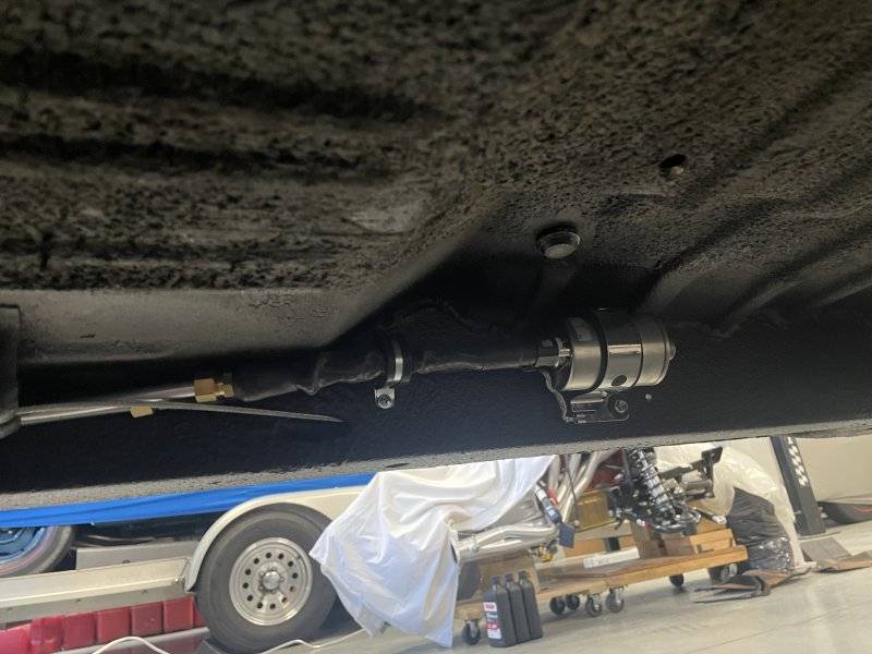

Damn, i thought that brake line was braided... just the rock guard.. my eyes are ****![]()
Is that a Corvette regulator/pump combo?
