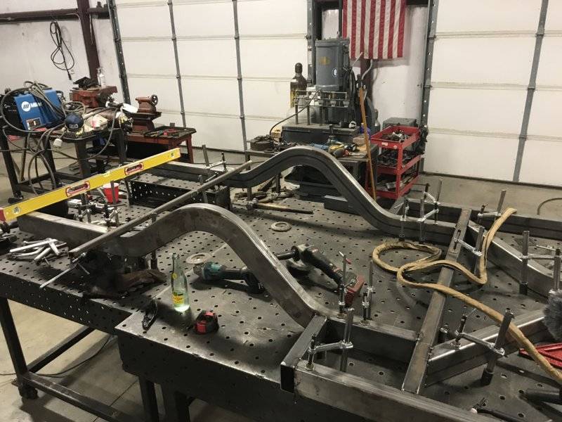

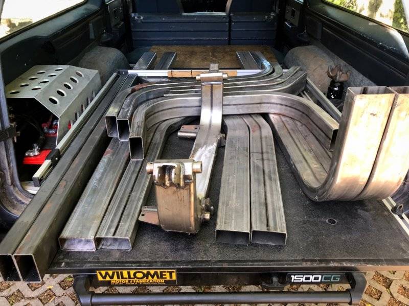

It was a full weekend of chassis building.
The Charger will only fit in the suburban this one time.

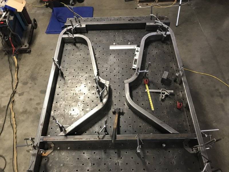

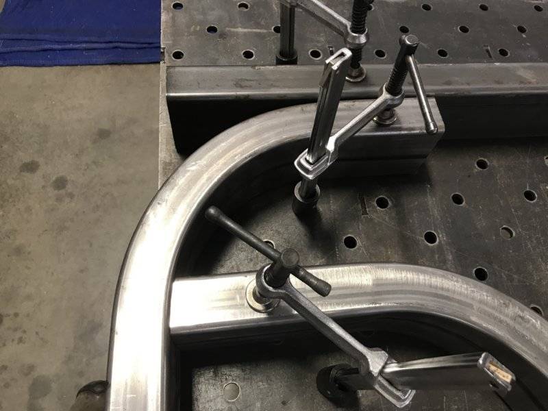

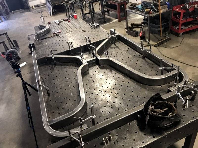

Setting up at my friends shop...
...he has two large fixture tables we made great use of.
Large rear torque boxes, and that crossbeam is placed at the same spot where the factory floor raises to the back seat - 33-1/2” forward of the axle centerline.

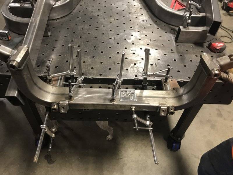

ChassisWorks from crossmember
Front torque box detail

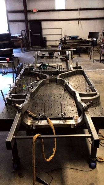

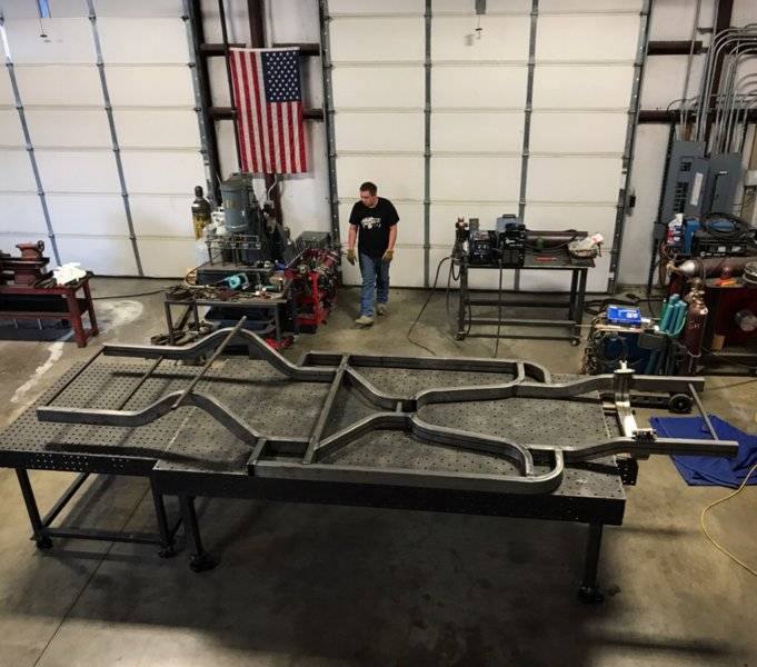

The modified X, making room for the setback powertrain.

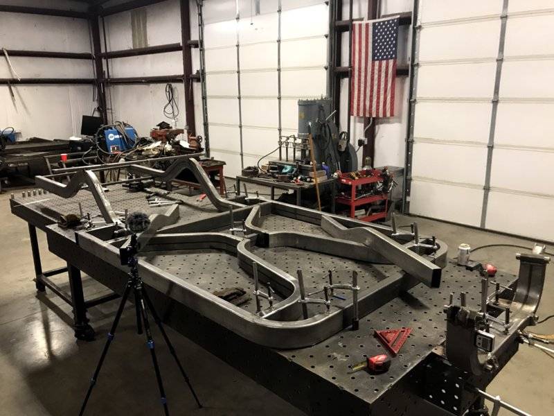

A long and enjoyable day of welding.
You can really get a sense of scale for just how big this car is.

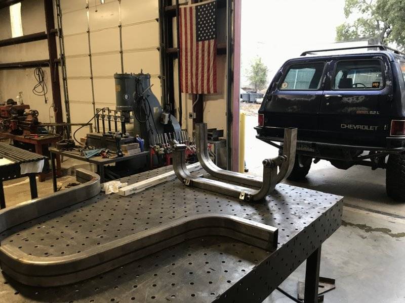

Everything is back at my shop, and there’s a load of detail pieces left to work - T plates, cap passes, driveshaft hoops, engine mounts, shear plates, and more stuff I’m forgetting.

So, David, where did the pieces come from? Are these the result of your measurements having been used to produce the bent pieces and angles by a second party? Like a steel supply that bent them for you. Or?
I designed the chassis, though it's inspired by several existing pro-touring and factory setups. Jimmy at MRC Fabrication in NC bent the 4x2 to my dimensions, leaving a bit on each end for trimming and fitting.
David
David
Can I ask what that cost? In a PM if you want...
Happy to share. My design time is a sunk cost, and I made 7 revisions before sending the design to Jimmy at MRC. The rails, bent to spec and shipped, were about $2500. Additional to that is the Chassisworks front suspension crossmember.

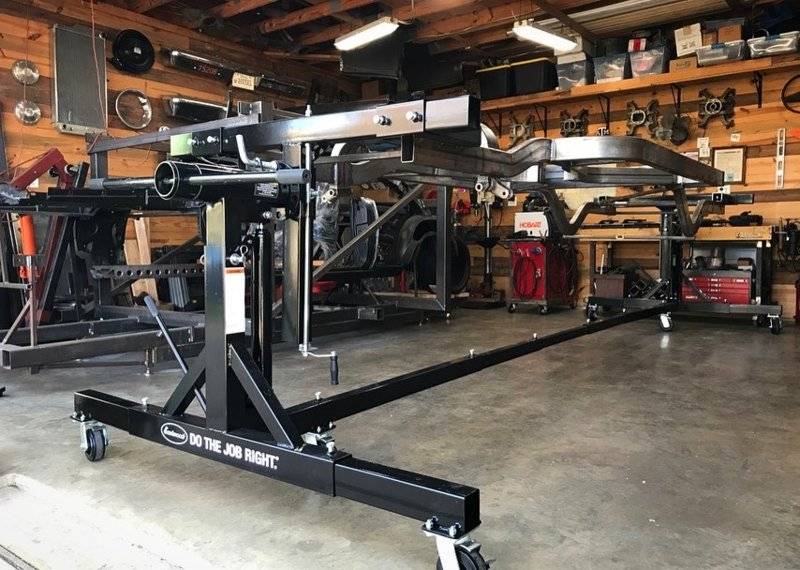

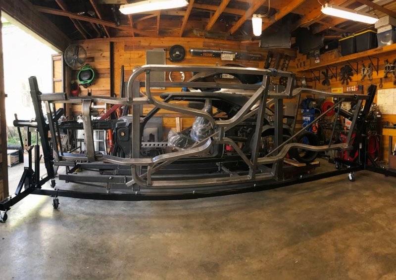

The house remodel is pretty much done. Deer season is done. Time to get back to work.

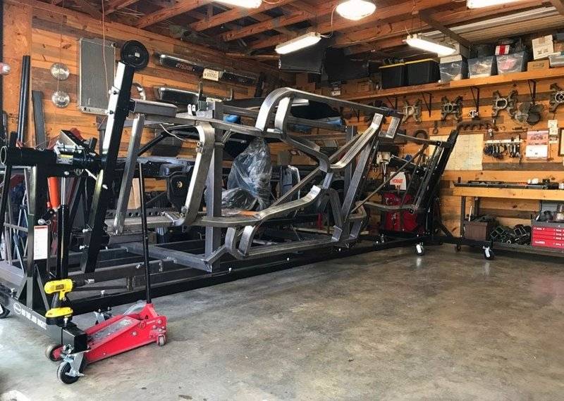

I snagged a rotisserie for the frame.

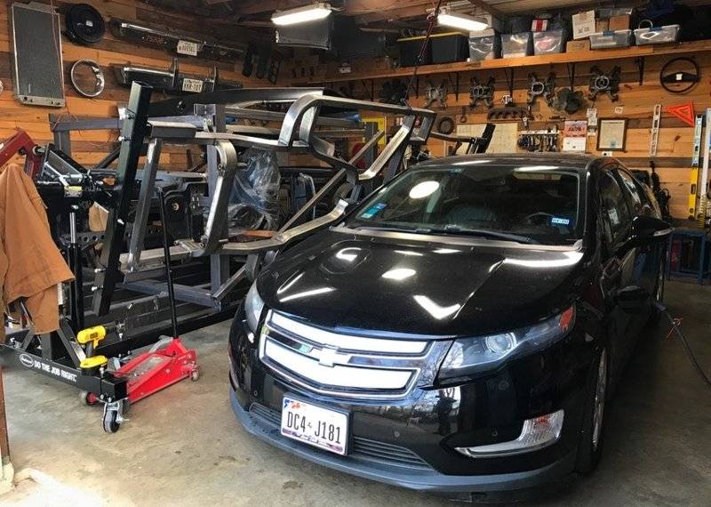

Now the car can park and charge, like normal.
It’s actually very easy to move around with one person. That might not always be the case, but it’s good right now.

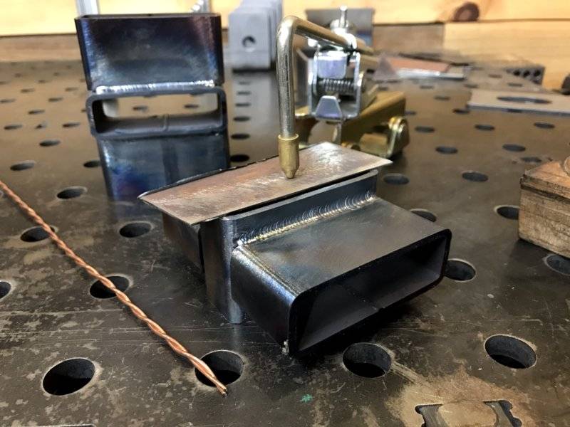

After weeks away, I’m dialing my brain back in; practicing for the cap welds on the frame.
I’m going to include more prep posts, and show my in-process steps. Said another way, I’ll show the junk I make before the finished product.
David
First time I’ve seen twisted tig wire. Can you explain why your doing it this way? I’m always up for learning something.
I ran out of 3/32. This was just a sub until I go get a new box. I don’t recommend it when doing lay wire.
