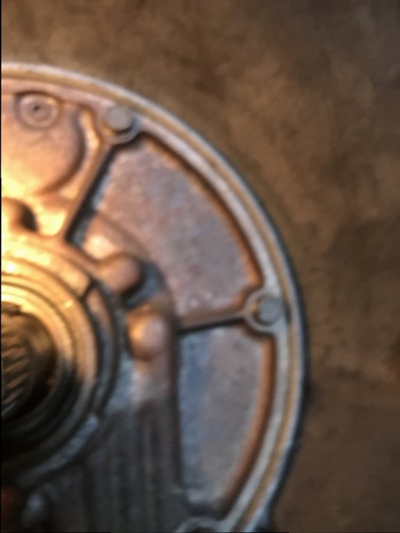

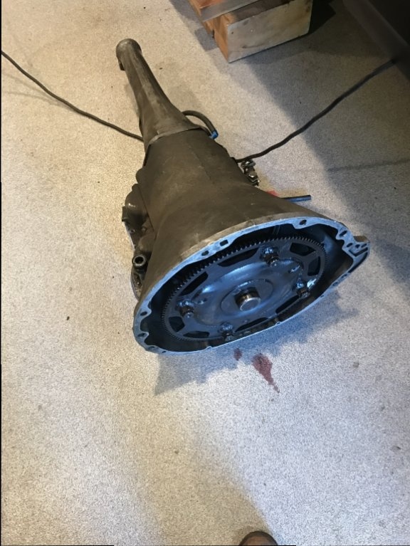

Just as a quick reference. The distance from the back of the block to the face of the flexplate, should be about the same as the depth of the convertor lugs in the bell housing face. Big difference between the first step and second, when installing.
