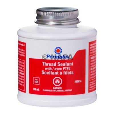

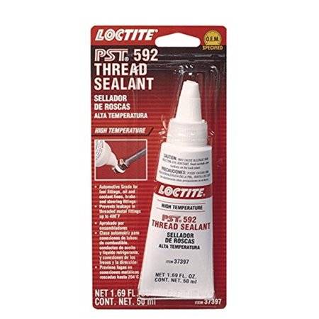

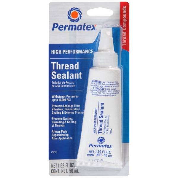

My go-to..
no problem, it will work great sealing the threads and stopping oil from wicking up the threads
These are all good products. Big thing to watch for is the temp rating; you wanna get hi-temp stuff.
