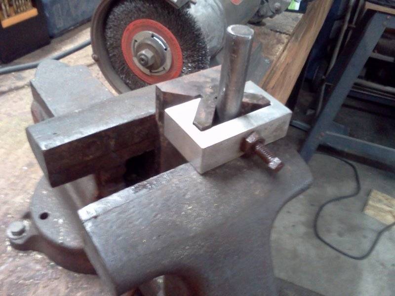

I found my X block and it has a clamp attachment I had forgotten about.
Kind of a smallish set screw with a jam nut.
I put that in my vice then locked in a rod with the set screw.
I had to tighten it quite a bit but it finally stopped the turning and allowed me to continue threading a 1/2 inch J bolt I had laying around.

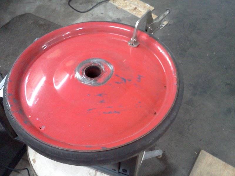

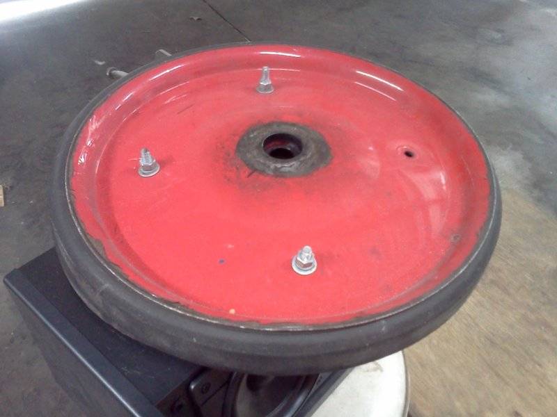

Hard to see in the pics but both wheels have had the metal wear through and stress crack in a complete circle. One has been welded back once, the other twice.
Ya, that's a valid point about the threads being a week point, better not to test that one out. Since you are going this far to make a custom cart axle, and these get rolled around a lot as you say... It might be a good idea to just get new wheels and bearings and then go from there. Maybe even beef it up a little.
If the old design didn't last before, it's not gonna last the next time around. The cart was probabaly meant for less usage/weight originally, or just poorly designed from the start
