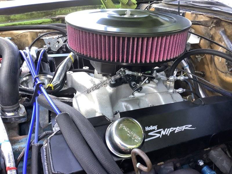

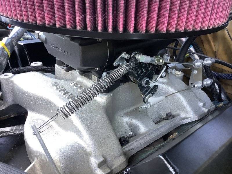

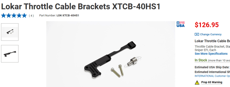

I used the Lokar bracket for the Sniper I TBI.....and the Lokar throttle cable with the Lokar transmission kick-down cable.
I recently bought a specific stiffening bracket to support the cable from Lokar to really get a solid hold on the cable ends at the TBI...
Lokar XTCB-40HS1 Lokar Throttle Cable Brackets | Summit Racing
Bracket accepts both cables - throttle and kick-down.

thx for the suggestion. if not too much of a bother can you snap a pic or two to show what it looks like at the throttle body?

I haven't fitted that fancy new stronger bracket yet - was supposed to be on by now, but work is getting in the way.
A few weeks if you want to hold on....maybe early September. :thumbsup:
Hope this helps you out. I have had both sniper 1 and then upgraded to sniper 2. The throttle bracket for the sniper 1 does not work properly on the 2 because the width is narrower and it doesn’t line up well. I used the original Lokar throttle bracket and it works great for both cables. It’s nice to be able to fine tune the kick down cable from the top side at the throttle.
Throttle response is very smooth with the return springs and feels like a regular carb would.
