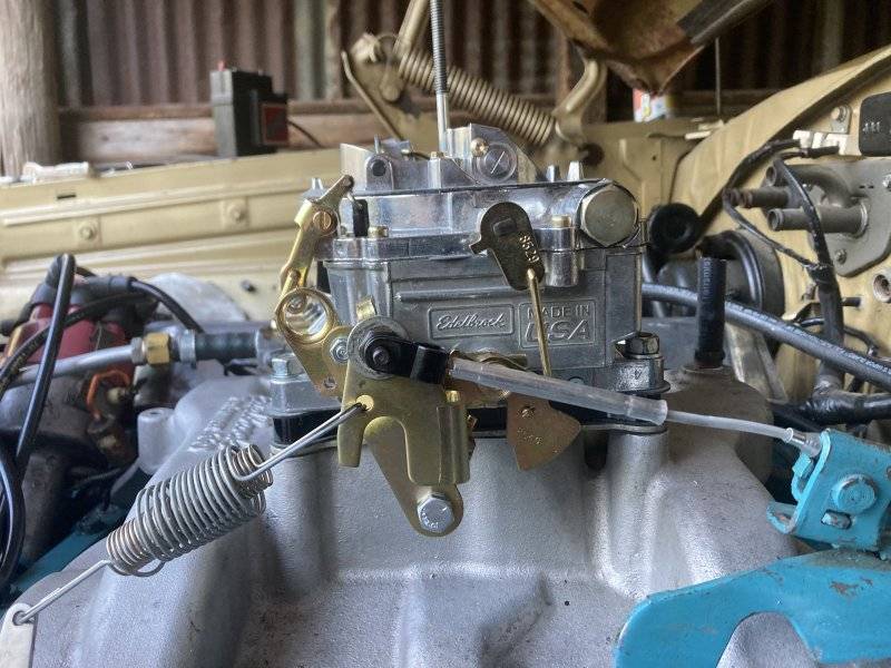

Well look what happens when you have the correct parts, thank you everyone for helping!
I hadn't given out one of these in a while, so there ya go. :thumbsup:
Well damn, plopped it on, turned the idle mixture screws out 2 turns as a baseline, didn’t touch the idle screw. I have an electric fuel pump, so I filled the bowl, gave it a pump, bumped the key, it fired up and idled!
Throttle went wide open, then shut. So this thread is done. Thanks for all the help guys, and any future readers, enjoy!
Unfortunately I was a little premature on my excitement of my AFR, it idles rich, I need to work on that. But that’s for another thread.
