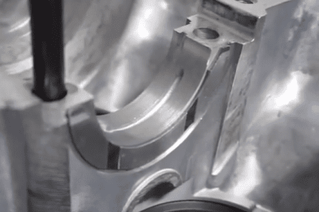

I've had a 505 stroker built for my 68 super bee. rebuilt 727 trans for high perf, new tci 3500 stall and new flex plate. put everything together. runs great, plenty of power. problem is oil filter is full of gold and silver shavings. pulled enging, dropped oil pan and thrust bearing is chewed up. engine guy says it's trans. trans guy says its engine. just wondering if anyone has had this problem????

Oil passages on bearing facing the correct way?
Did you put a Dial Indicator on crank and
check thrust bearing clearance when assembled?
You'd be surprised at how many people don't check crankshaft end play properly. Could be converter issue. Perfect reason to build your own stuff and keep notes.
If the engine and tranny are in the car still... get under the engine and try to move the crank fore and aft just to check what level of movement/clearance you have (there should be a little). If you have none... something could be bound up. If you have a lot then that confirms the need to replace the thrust bearing. Nevertheless if it does move, especially to the rear, watch the flywheel and converter.
I've seen more than a few converters lately that are to snug in the crank. Various brands of cranks and converters. Make sure the converter slides forward to the flex plate by hand with no bolts. Thrust failure in BB Mopar isn't to common.

I have seen main bearings installed with the wrong half in the saddle. That would cause lack of oiling.dropping the bearing cap would tell you. The motor would still run…
Are you sure it’s the thrust bearing? It could be cam bearings too. Especially if there was a problem installing the cam bearings not lined up correctly or one of the main bearings installed upside down or a cam bearing not properly lined up for oiling. See if there is silver/gold in the galley.

If the main bearing was installed upside down you would have way more issues that the thrust. The rods fore and aft of that journal wouldn't get any oil with the oil feed hole located in the cap.

A lot of possibilities. Was there a burr on the saddle to distort the bearing or crank? Were the bearings checked for clearance? End play? Wrong bearing? Plastigauge everything? Is the thrust bearing worn on just one side?orboth? Was the damper torqued properly?

Start with anything that can load the crank in the direction the wear is - assuming it is only one direction.
