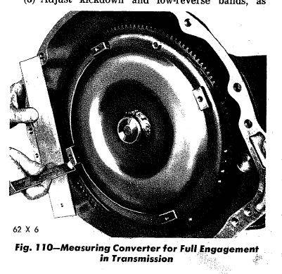

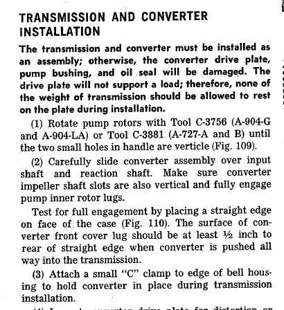

If someone is “checking” the fit, what should that be? The converter penetrates into the crank and has clearance in the counterbore?
This coming from a manual guy and has a 340 automatic ready to assemble in the near future. I’d like to know my converter will not cause any problems and want to know how to check that.
