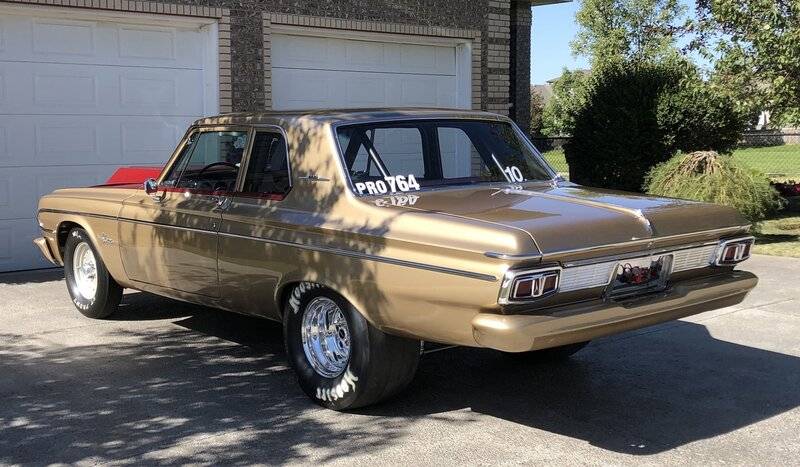

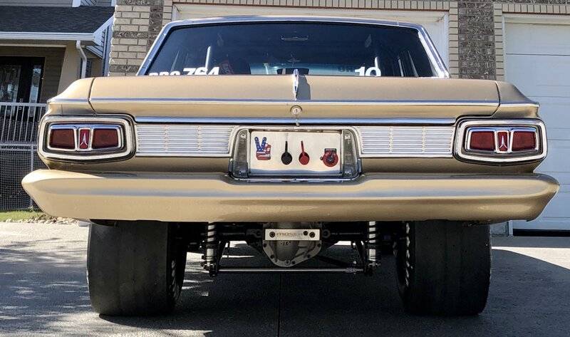

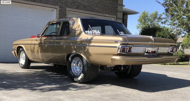

Changes: Trying a shear plate under the dominator, some jet changes, hockey pucks for bump stops and new big rear tires.
Hoosier 29.5 X 11.5 W’s. 96” rollout, 15.2 cross section and 13.25” tread. The new big tire’s additional circumference may take away a little on both ends, maybe not, we’ll soon know. Maybe turning the little 505’s launch RPM up some too!

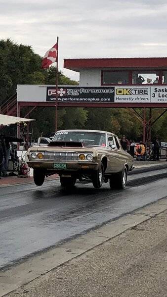

A couple pics, and an ok way to end the season.

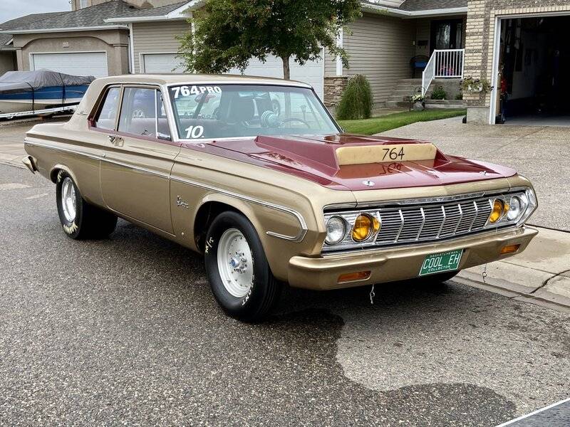

Of course the traditional load pictures..
The rain has stopped!
Sure is a dream to load the sedan with the left side trailer door, no regrets building that into the trailer. Sure not going to make the mistake of running too low of air in the rear tires like I did last time..

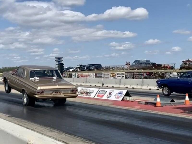

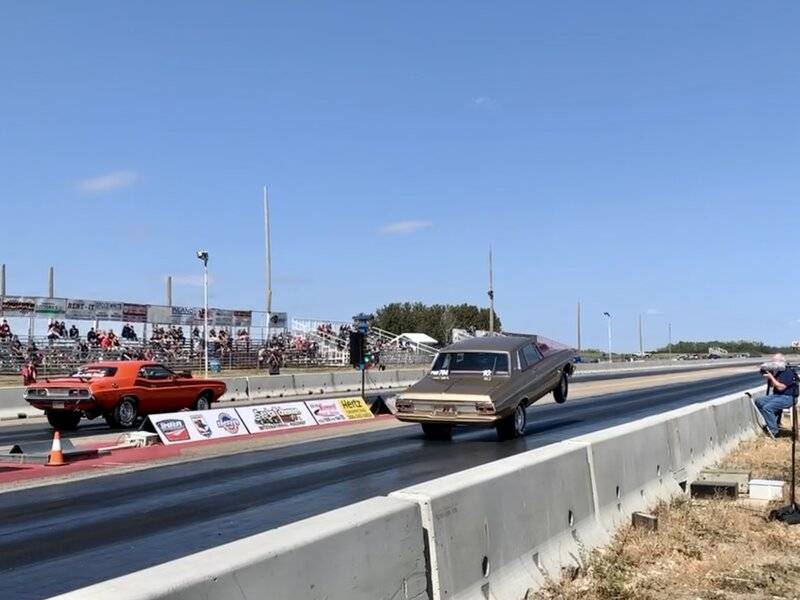

Another weekend in the books. Got in one day out of 2, rained out on day 2. The 64 worked well with 133 60’s and in 3 hits it went 10.07, 10.10 & 10.06. The car worked better than the driver. Lol. My day was over early on after cutting myself a .024 only to come up against a .000. I was able to run him down, and take the stripe with ease, expecting to see my win light come but nope, I broke out. Damn.
Wooks ran well also, although neither of us brought home any silver this weekend. We are back at it in 3 weeks for the last double hitter plus a make up race day from today’s rainout.
I did grab a short vid on a test pass and a couple of launch shots.
