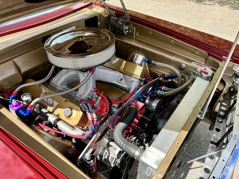

Starting over fresh and clean. A 16X3” air filter this year. Shorter due to a new scoop. The rest of the package remains the same.
Liking the looks of the new 3” scoop.

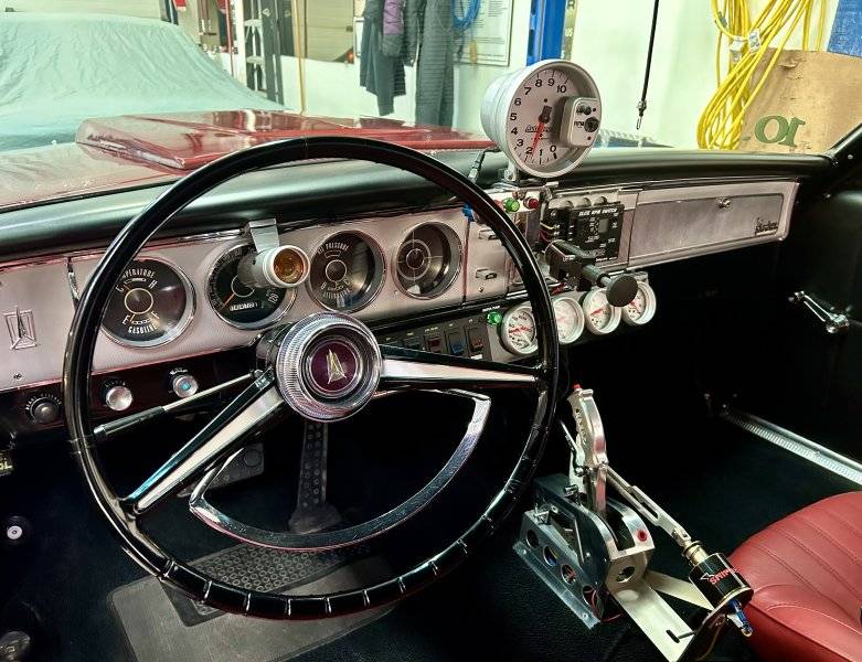

great looking car !! is that large pushbutton sticking out from the dash the electric shift solenoid button ?
