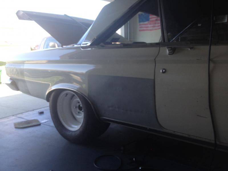

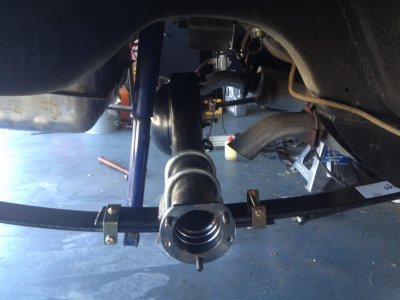

10 inch wheel with 5 inch set back, 12 inch thread 13 1/2 inch from bubble to bubble, mini tubed shortened axle to 49 1/2 from flange to flange
I'll get more pics for ya !!
Thanks for response. Looks great. What type of leaf spring is that ? Any chance you have pics of mini tub or advice on how hard it is to do ? I think I can handle the dana, the frame ties and the spring relocate but really afraid of the tubs. Also, with the current 8 3/4, any idea if I have to replace my driveshaft ? I am running an original 65 727 and shaft now. Thanks again !
