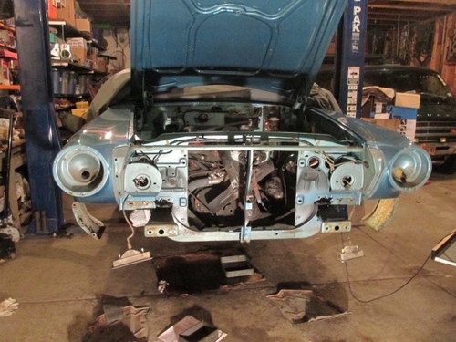

Best way to do it by far!
I use furniture dollies from China freight to build up a rolling "fixture" and roll the whole deal right out from under the body.
Basically, just make sure you unhook everything and lift.

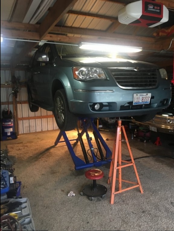

We're working on my sisters town and country going to pull the motor trans and k frame right out, we have it on a scissor jack/lift disconnect everything and lift the whole body roll the assemble out from under

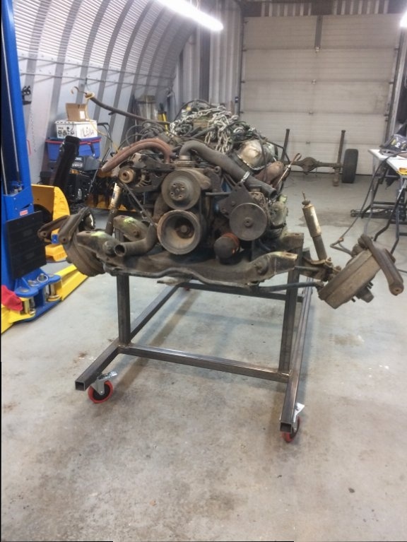

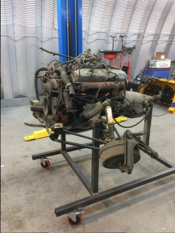

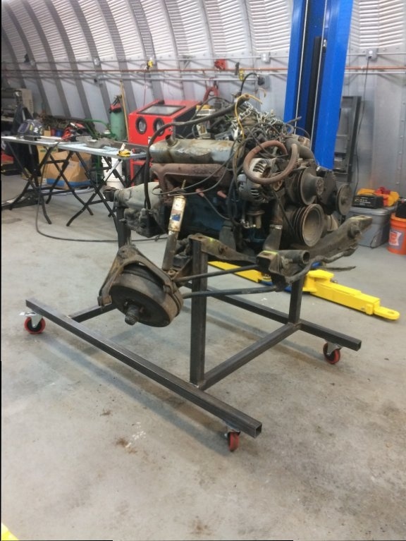

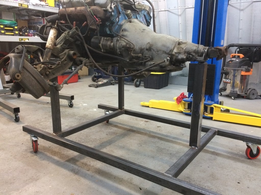

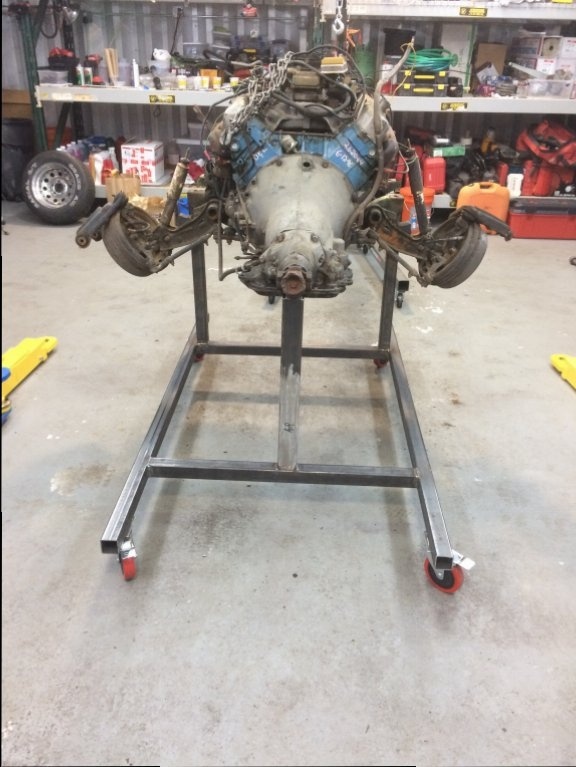

I dropped mine out (first time also) by building this little roll cart. I made the transmission rubber mount drop into the rear tube so I knew it couldn't go anywhere. K member, suspension, engine, transmission are just resting on the front tubes. When I roll it around I drop a few large bolts in the front holes in K member. I just dropped it out the bottom by raising the car on a 2 post lift. Really the hardest part was driving the torsion bars out, but now I have the clamps they sell. By making the tubes tall, my thought was if I had to sell the roller, the next guy could trim the tubes lower if not using a lift. Just trying to cover my bases. Was pretty simple to weld up. Cost me around $60 for steel and $50 for the wheels. Maybe 2 hours with a welder, plasma cutter and tape measure.
If you have any questions, just ask. Definitely the way to go.

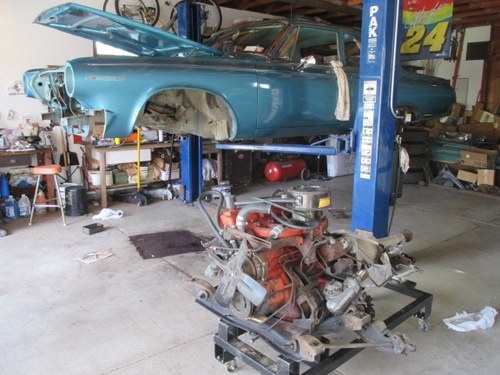

I do it without a lift. Put it on jackstands, then disconnect everything but the K frame bolts, removing the T bars after unloading them, and leaving a couple bolts (without nuts) in the trans crosmember. I use a jack that is low profile, and raise it through a HD furniture dolly to jack it up off the jackstands. Pull the stands, and lower the car onto the dolly. Unbolt the K frame and pull the bolts from the trans crossmember from the sides (not under the car). Then I slip the 4x4 in place and lift the body off it.
