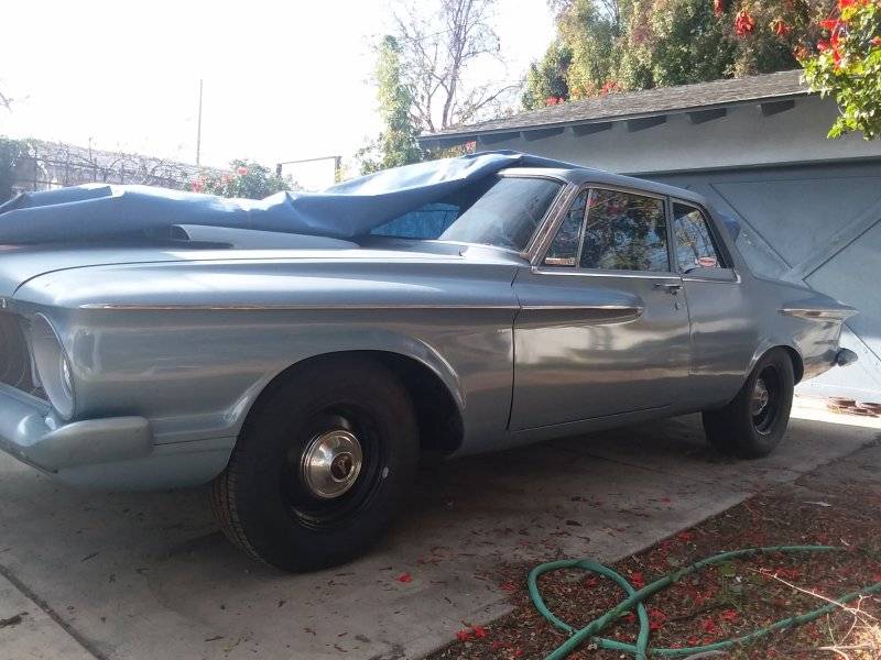

I test fit 2 different wheel/tire combos on the rear:
15x8 4.25 bs with old dry rotted L-60 MT - very squared off, and they just barely fit.
15x8 4.5 bs with new 275/60s (supposed to be comparable to the L-60s) - fit the same, the space between the tire and the quarter/lip are the exact same.
Not sure why a bigger offset with a more rounded tire fits the same?

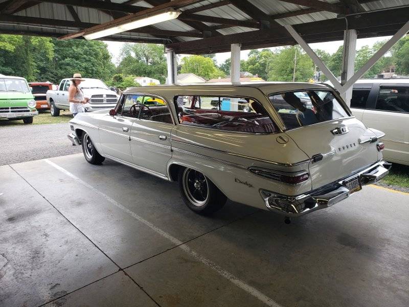

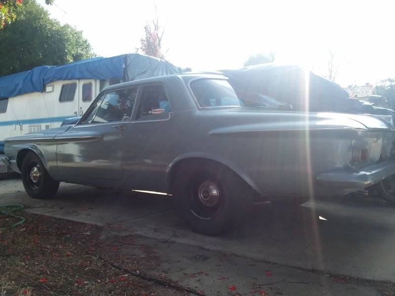

First 2 pics are the L-60 MT, last is the 275/60 on my 62 Dart (more rounded tire, larger bs, but fits the same on the wagon).

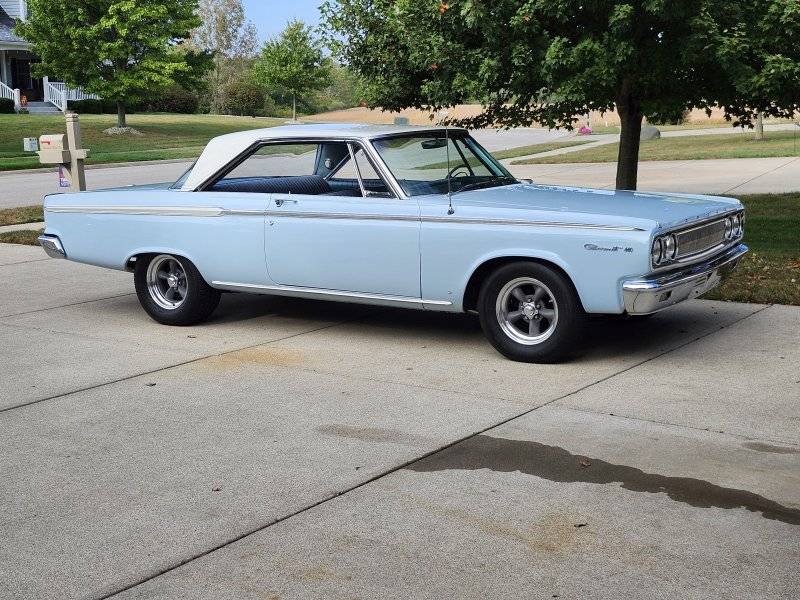

I used 215-75x15 on 5 .5" steel wheels and 275-60's on 8"-4.5" backspace steel wheels on my 65 coronet once. No fitment issues.
I like that, nice combo. Especially the nice tall 215s, if you have clearance for the height. But with not QUITE enough backspace on the rear (same problem I had) a 255 is probably a better fit for matthon. My opinion only.

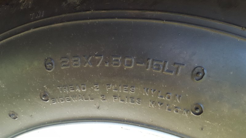

I found a pic of the tires that were on the 5.5 wheels when they were on my 64 Belvedere 2 door.
28 x 7.50 - 15LT
That's too skinny for a daily driver, for me anyway.

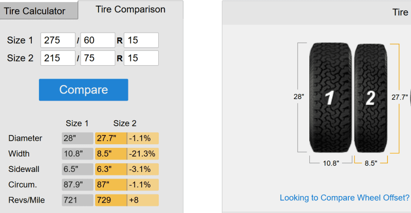

I would love to run 215/75 in the front with the 275/60 in the rear, both basically 28" tall, however even with the 4.5bs and the narrow later rear, the 275 is very close.
Maybe it would be better to run 215/70 in the front with the 255/60 in the rear, as they are basically the same height at 27".
Not much taller or wider than my current 14" tires, but they're all 15" and I'm limited by the 5.5 front wheels and the tight space in the rear wheel wells.
I still don't get the space in the rear, it measures the same as my 64 2 door, and both cars have had both the 64 rear, the later rear, and both rear wheel/tire combos. Fit fine every time in the 2 door, too close for comfort in the wagon.
265/60 with the 215/75 is a good match and gives me ~ 1/2 inch more than the 275/60.
I can do this all day, and have before, but what matters is what sizes are available, 265/60 might not even exist, so I need to call around first.
