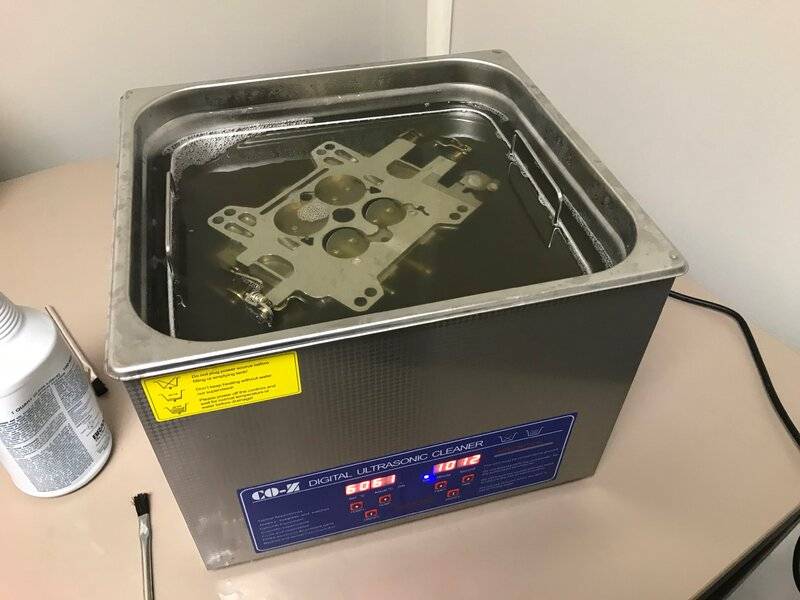

In the process of rebuilding the carb on the Power Wagon. Went to Autozone and picked up a fresh can of Berrymans carb cleaner...what a waste of 30 bucks. Put some parts in for an hour, still had carbon and drool deposits everywhere. I remember when you could buy carb cleaner and the soak wasn't more than 30 minutes, everything came out spotless. Todays ****...not so much.
Figured I'd put the Ultrasonic to work....

Nice big ultrasonic. What do you use in it?

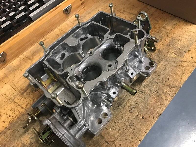

Boraxo / water most of the time but I thought I'd try some of this Ultrasonic concentrated cleaner that came with the machine... so far works really good. Parts are spotless, coming out of the tank around 160 degrees F.

Years ago an hour was plenty to clean a carb but, since they removed the ( I think) acid that did the work I leave them submerged for 24 hours and go right to the solvent tank to manually brush off the soot with solvent rinse. I used to do at least one carb rebuild a week. Now it's like 2 a year.

That carb looks great. Is that CO-Z ultrasonic cleaner the 2L model?
