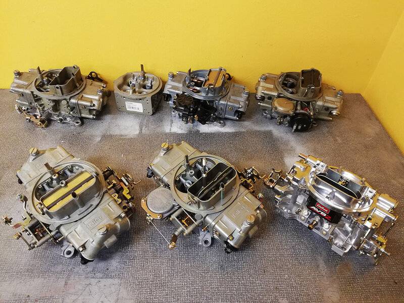

I have gone through a couple of carbs to learn how to tune and the Holley 650 Vac has been a champ, so I dont want to drill in it.
Ive ordered new parts now to build my own carb, Holley style, with adjustable pvfr and more, also new main body with choke delete and adj air bleeds. Lots more to play with.

Probably depends on what kind of carb a guy is dealing with as well. I've been running Quick Fuel Q and SQ mechanical secondaries lately. I have had to mess with the PVFR's on all of them. I would bet that vacuum secondary models would be a lot closer from the factory for street use.
The 650 VS worked great with factory settings. (So did the Eddy avs2, that annular booster is nice.)

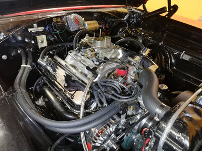

I cruise at 2000rpm with around 13.5-13.8 afr, 2500 almost same, 3-4000 it goes above 14.
Edit: I was down at 60 for the primary jet to reach 14.2afr, though my engine didnt seem to like that.

Allright, weekend is over and I got some readings.
First the vacuum:
Idle park: 20Hg
Idle gear: 16Hg
Cruise 2000rpm: 17Hg
Now, my afr for cruise went up a little to 14 (No primary jet change) ...could this be because the weather suddenly turned warmer here?
Just for the heck of it I changed the secondary jets three steps up to 76 and reached a WOT afr of 13.
Now for the interesting part, as beanhead said: "Some of those carbs have been know to have a too-slow secondary opening rate as well".
I did the zip tie test again on the VS and this time really carefully went on one WOT runs and checked the zip tie directly afterwards.
I found out that the secondary does not open fully until 4000rpms, this is also where I got the 13 afr reading.
So for next test Im going to try one of the lightest springs (I dont have a screw-adjustable VS yet.).
Quick question: I do get the same results when testing VS opening rpms at first gear, right?
(When going 4000rpm 3rd gear with a 3.23 rear I am nervous about any cops being around.) :D
ps. It has electronic ignition with the little black box from Mancini.
