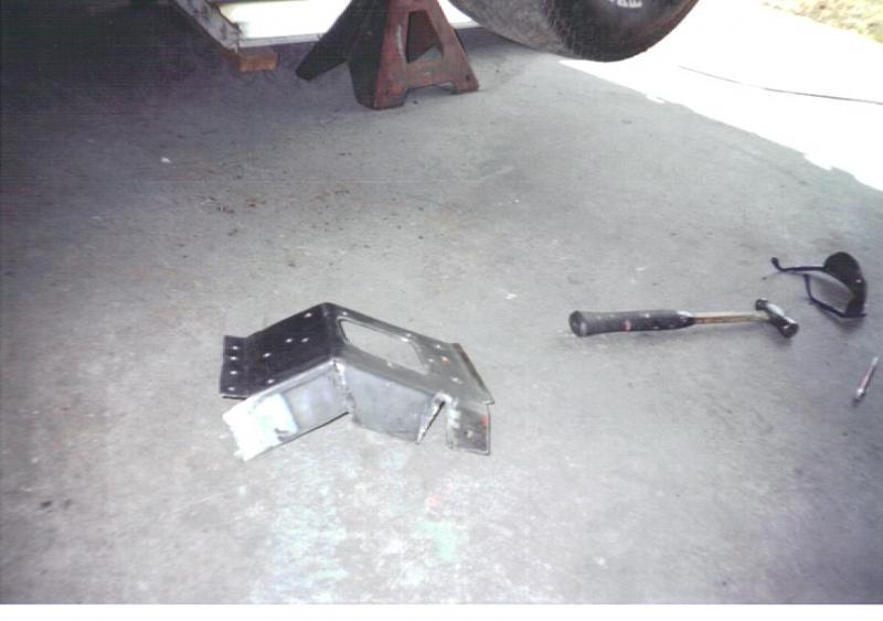

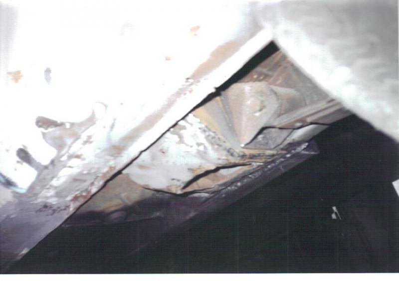

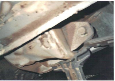

Has anyone built their own torque boxes? Just wanting to know what gauge metal is best suited if I build my own.I have some fabrication tools and the ones I`ve seen look fairly simple.I would appreciate any TIPS or PICS of store bought or self made ones.They will be going on a 1970 Superbee.
yes 18 gauge is what we used , mine were really beat up . These are on my superbird convertible .
