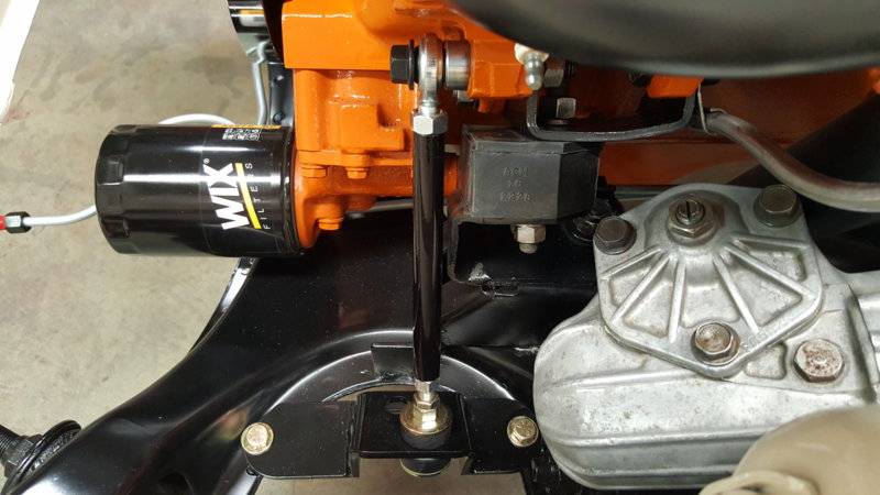

The factory mounts do have a reputation, especially aftermarket ones. I happened apon some NOS (made in the USA) but I wanted the extra insurance so I bought a Schumacher strap. I wouldn't want to be without one.
This one is for a "E" body. I don't have power steering and didn't like the crooked bracket that they went to for power steering. Had to make a bushing and find a longer mount bolt. (1962 Dodge)
I have the same one that kryslerkid has but for my 71 RR with power steering. I also installed "Mighty Mount" brand of engine mounts as well.
