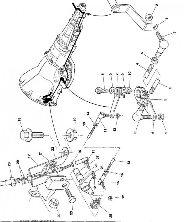

I think, the late virage with 4-speed auto is a transition to the V8 Model in 1996. (see attached drawing of this V8 gearbox) Am i right, that they have the same gearbox?
If your gearbox looks like the one in this illustration then it is a 518 and will have a two or thee wire connection on the drivers side of the trans to the rear of the linkage. Both the lockup and non lockup have the same oval shaped female case plug, the non lockup version is bright yellow with two pins, the lockup is a tan neutral color with three pins.
