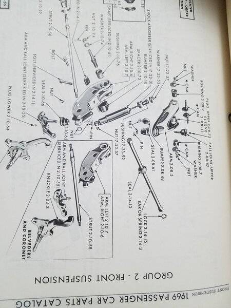

Maybe it is a 67 only thing? Here is a pic from my 69 parts catalog, it's not shown here.
