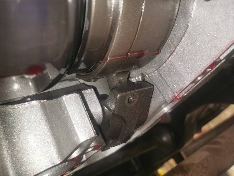

That is how it looks like. It's different from the video above. There is no strut to take out. I contacted Transgo support yesterday. They answered me even on Sunday :). Their technician says in my case with the double wrap band, I have to take the tailshaft off.

Band strut would be at opposite end of band pictured. Adjustment screw has to have something to react against.
Please stop with band strut. There is not a band strut on this rear band design.
The adjusting screw is pressing directly on the band. You can see that in the picture.
There is no question, to work on the rear servo the tailshaft has to come off.

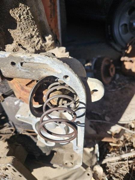

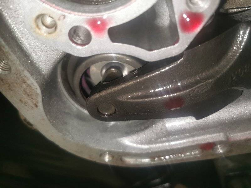

I have the same transmission in the shop. You don't need to pull the servo to switch the spring.
Take the snap ring off that holds the spring pushing on the servo.
Slip the stamped steel spring holder over the cast arm so it's out of the way.
Pry the end of the spring up enough to wind it out over the band apply arm.
Install the new one by winding it back in.
The new spring looks similar but is much beafier..I would switch it.
The new spring will certainly take more effort to wind in..but should not be a problem. I posted a picture so you have an idea of what I mean by "winding it out".
