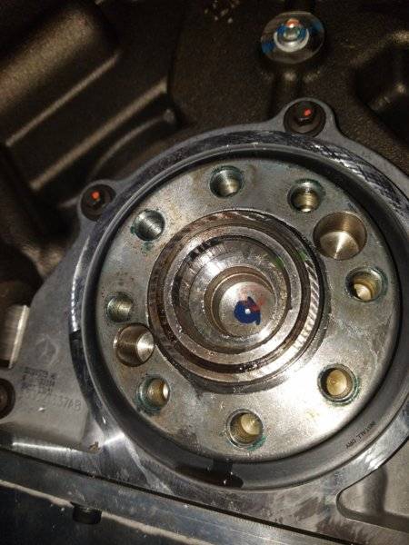

The converter snub is slightly tapered in the front
Front of conberter snub/button 1.66
Rear of conberter snub/button is 1.80
Crank opening 1.35
I measure the opening if I remove the pilot bushing and it appears to measure 1.80
Pic with flexplate off

Unfortunatly im not a welder and have not the supplies or the skills to do this. :(
That inner ring has to come out.

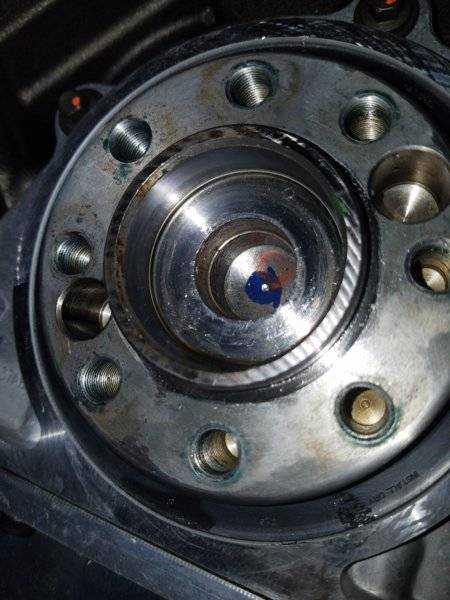

I picked up another tool today from autozone that really gets behind the ring. Unfortunately that ring is in there really tight. The slide hammer didn't nice it a mm after 10 min. Going to get back at it tomorrow. The k you for your input!
Heck yeah guys...i did it. Praise God!

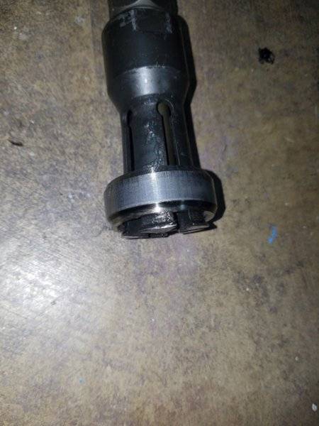

I used the tool from Autozone called a blind hole puller. It's much better in my opinion than the pilot bushing puller from oreillys.
Anyhow I rented both and swapped the 5lb slide hammer over to the blind hole puller because it came with a 3lb slide hammer.
Also I suggest you slide the hammer when your body is halfway out from under the car. Being directly under the car you can't really get enough force on the slide hammer. I tried it that way for 30 minutes and it didn't move a mm. I changed positions and the pilot bushing moved within the first 3 whacks.
Trans is hooked up now. I just need to tighten the trans to engine bolts and then hoom up the converter to the flexplate.
