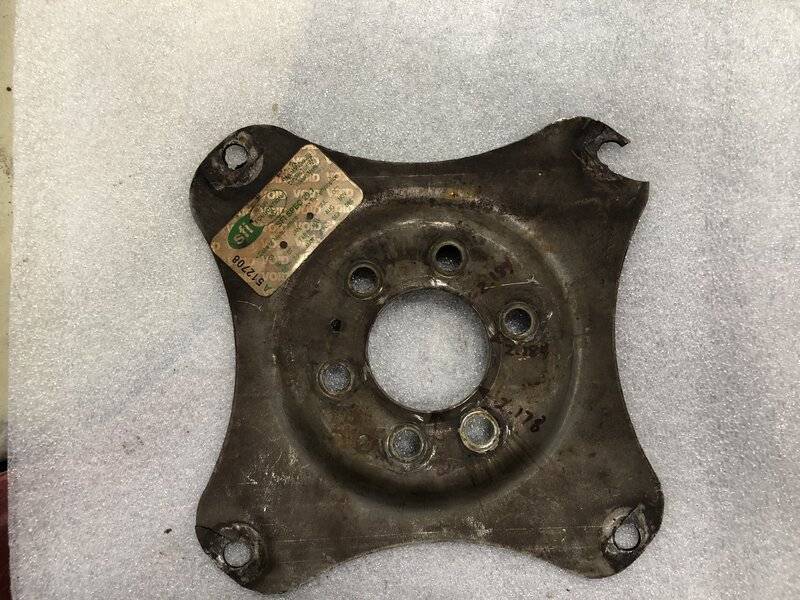

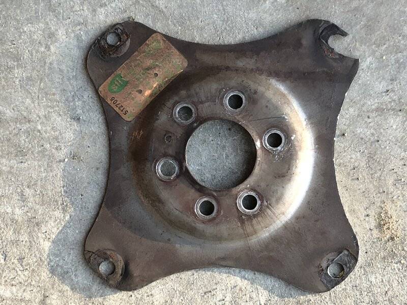

I've had the 4.15 crank since 2004. I've only had this one flexplate on it and I'm sure I had to file it oversize. Maybe that is why THIS happened?

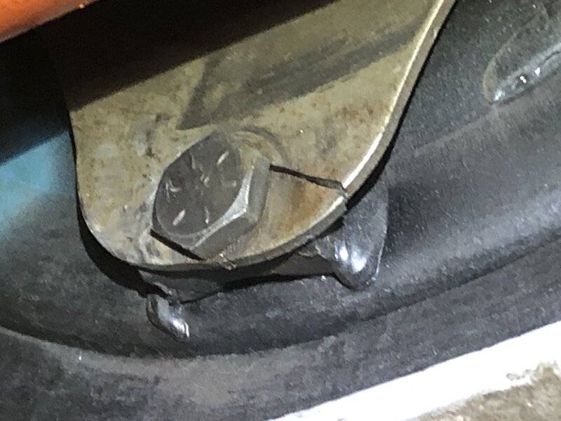

Maybe my backyard clearance job had some radial runout?
I think it may have been a factor, the bellhousing misalignment likely also contributed...

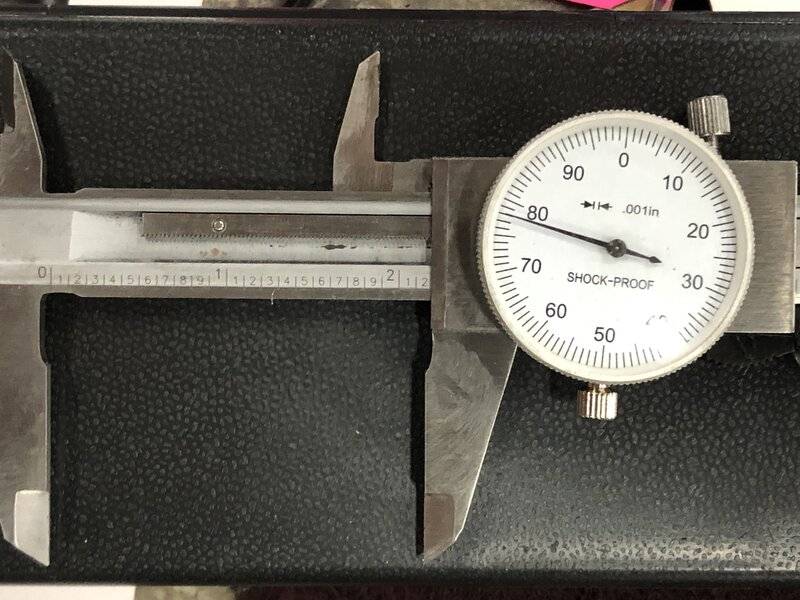

I measured 2 other cranks and came up with the same size as the flywheel holes. This 4.15 stroke Ching-Chong crank is the only one that measures larger.
I used the green Harbor Freight micrometer and came up with 2.1875.

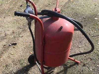

To get the paint to stick, I need to rough up the surface. I could have taken the parts to a Bumper shop to have them DEchromed but who knows how long THAT would take? Plus...Who still does this in California? The only Chrome shop I know of is quite expensive.
I decided to sandblast the parts.

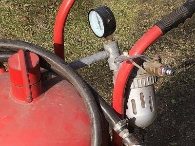

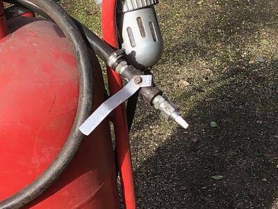

I have THIS pressure pot:
View attachment 1051000 View attachment 1051001 View attachment 1051002 View attachment 1051003
But the hose was blocked. Remember this topic?
https://www.forbbodiesonly.com/moparforum/threads/sandblaster-replacement-hose.209528/
I've got the same sandblaster. I've had it for 13 years and now it needs a new hose. I think I've found it at the local hardware store.

The machinist I spoke with wanted the crank measured as accurately as I can. I bought a stainless steel dial caliper to get there.

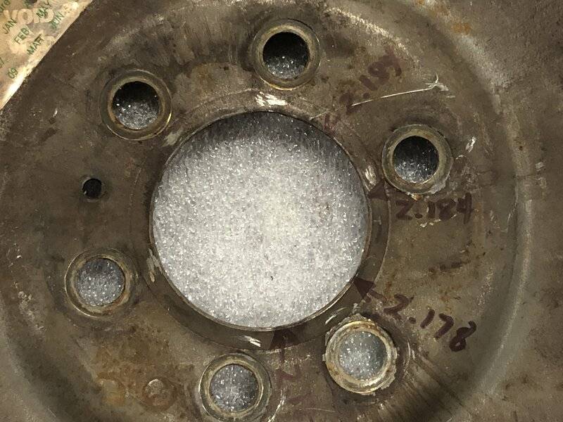

Here are the numbers of the crank hub :
This looks like 2.178 to me. Am I right?
The A/T flexplate is a bit beat up.

I measured it in several places.

Bonehead logic tells me that it makes sense to machine the flywheel to the smallest measurement on the flexplate.
