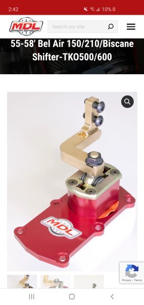

I'be been meaning to do a 5 speed swap on my 66 coronet 4 speed non console. The shifter location just bothers me since its in the middle of the tunnel and i dont have a console to hide it. Did you happen to take measurements how far the shifter edge is from the firewall? I'm curious if I used the rear shifter and offset it to the left if the shifter would line up the ballpark of the factory 4 speed location..
OP Congrats on getting in the 3 pedal club!

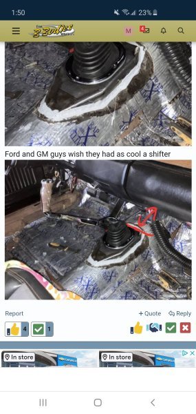

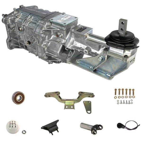

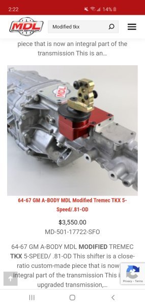

Actually SST solves that for you... They have a shifter designed to come through the original shifter hole...
Not sure which hole you are talking about?
With the exception of the Passon A-855 overdrive, I am not aware of any aftermarket transmission that comes up through the original 4 speed shifter hole. All require some sheet metal surgery.
The bracket with the arrows pointed at it moves the shifter back and to the side where the stock shifter pokes through the stock hole..
That's for e bodies and late b bodies. I have a 66 b body.
I was looking at the mdl modded version for the bel air. Looks like it might be option. Screenshot_20231231-022243_Chrome.jpg
