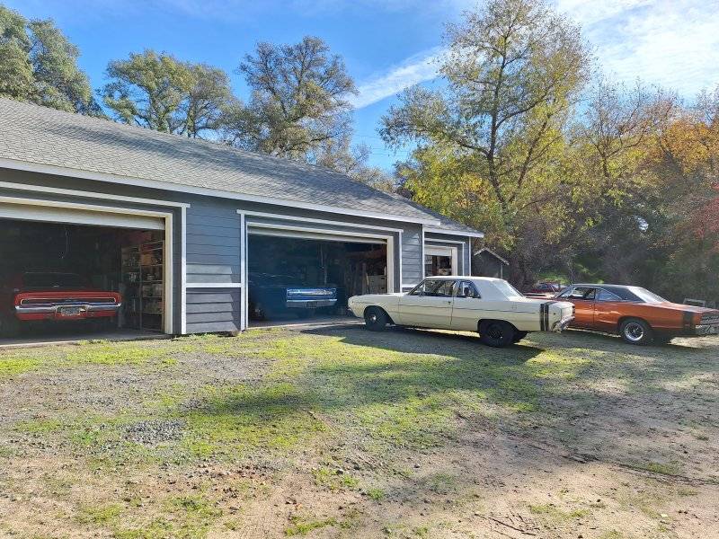

I drove the Dart to Greg's to fill up the trunk, and give him the opportunity to follow me back home. Not many people have driven the Dart; Hawk and Dwayne are two members that I can think of. Greg has owned lots of A bodies so I was wanting his opinions on the Dart in general, and the 17+ years old Tremec in particular.
Greg's shop had its own Mopar car show

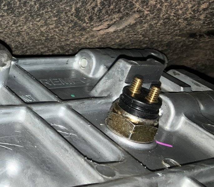

When I soldered the backup light pigtail, (supplied by SST) I matched the colors of the wires. It wasn't hard....the SST pigtail was black and violet, so were the wires to the factory wiring.
The sensor on the transmission had just two threaded posts so even if I had it backwards, flipping the terminal plug end 180 degrees should work.
Oddly, the lights come on with the key in the ON/RUN position if the engine isn't running. Once the engine starts and runs, the lights don't come on. Rich may try reversing the plug to see if it makes the difference.
There should have been three wires on the transmission NSS plug... The center wire is the neutral signal for the starter... The two outside wires are for the reverse lights... Polarity doesn't matter.... If you use the Neutral wire on the signal side of the back up lights the lights might come on when starting the car....

I don't remember if the wires were all 3 in a row or in a cluster. Regardless, the easy test is to flip the terminal plug on the sensor and see if that fixes it. If not, more detective work will be needed. Electrical matters? I'm hit and miss on this stuff.
The neutral signal wire should be brown.... Black & Violet should be the correct wires....
Violet is the lights, black is the power... Your problem is probably on the power side...
Something in the Start circuit overrides the reverse light circuit, even when the key returns back to Run. Reversing the wires is the first step.

So after studying the schematic there's conflicting info... End of the day I would look for 12V on both wires at the trans plug. Then jumper the black and purple and see if the back up lights come on & stay on... If so it's the switch on the trans that is bad...
I suspect the problem might have been there all along, the soldered wires are correct....
By look for 12V on both wires, my point is one should have 12V the other is the wire to the lights...
If neither has 12V the lights won't work...
The lights working till you start it is weird and confusing..
