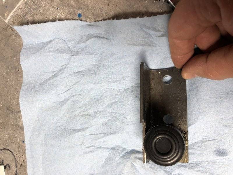

Here is the pedal stop. Angle iron, 1/2” bolt and nuts and a chair leg rubber. I used the lower 2 bolt existing for the slave cylinder for mounting.

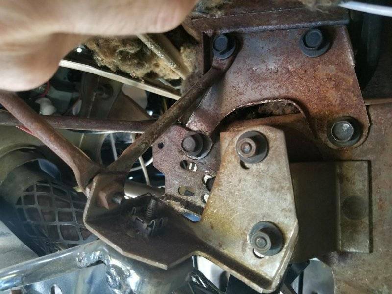

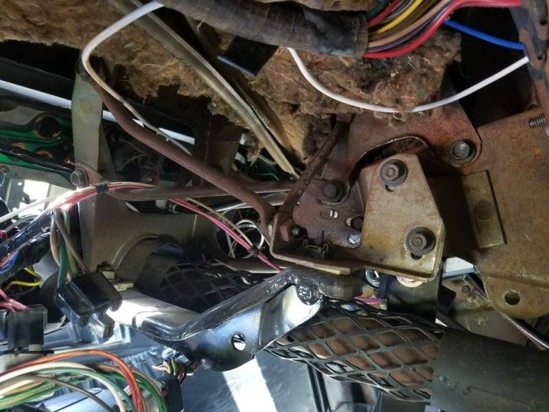

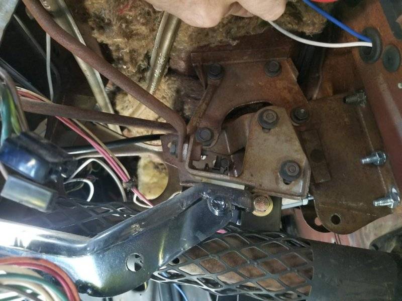

Here are a few pictures I found online.
These are from a 69 Charger.
My '70 looked different.
That's the bracket; those are better pics than I took. The tricky one is the bottom left corner of the bottom pic. Two tubular brackets attach to the bolt at a right angle, leading up to two other attachment points that have to be loosened so they can be swung out of the way. 60's safety origami.

Final notes on the bracket assembly; the bolt heads/nuts are different sizes. Yep, some engineer designed it so that you need a 1/2" and 7/16" socket; its tight in there so use a 1/4" drive ratchet. And a 6" extension; but only on some of them. Good times, good times...
That's a great idea; I'll keep this handy in case I need to make one. I take it the nut and bolt threads on the back of the stop clear the firewall. In the pictures the depth of the bolt looks longer than the depth of the mounting bracket.
