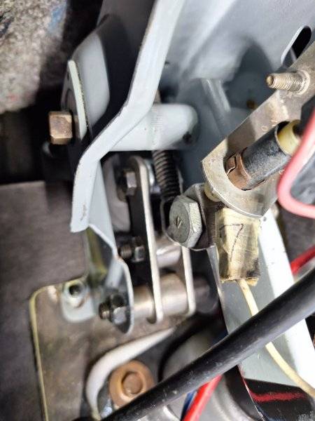

Not much, it's supposed to prevent rattles...Clips to the pedal support bracket directly above the dog bone link & hooks in the groove around the dog bone... I use a hook style scribe to get ahold of the spring & pull it into place...
It was attached before I started disassembling the brake pedal. Now it's hanging from the top of the cage, just having trouble getting it into the groove on the dog bone. It'll try your method. Thanks.

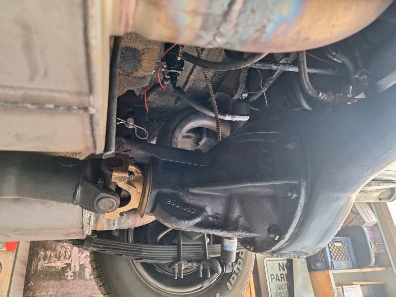

Car has a Tanks Inc. baffled tank with electric fuel pump. Here's a shot of the fuel filter, and the pinion snubber.

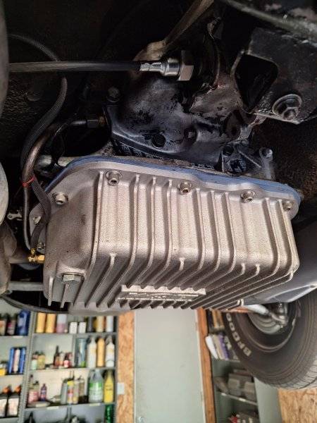

Tranny pan is a B&M; deep walled with fins, sending unit and drain plug.

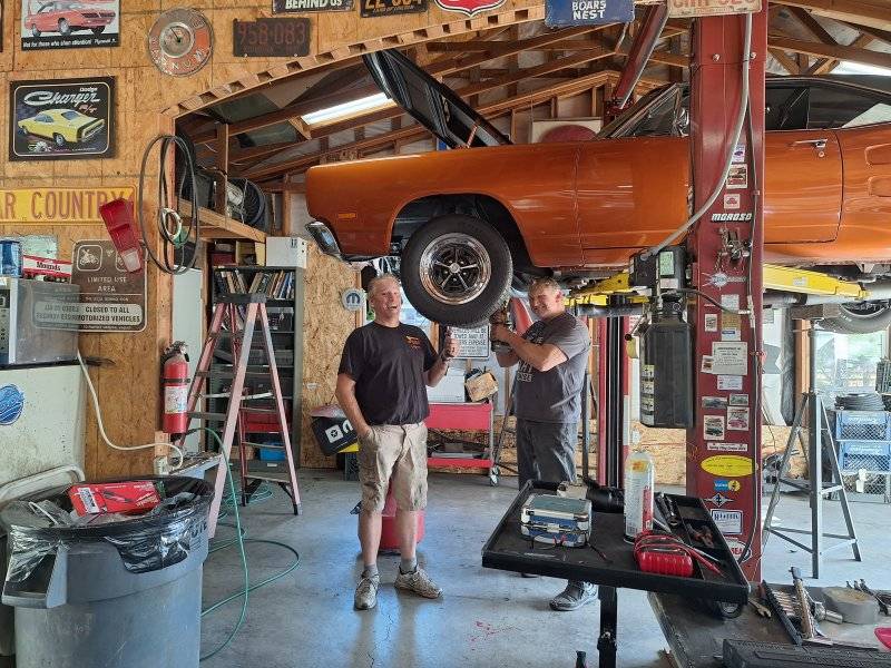

Two guys working hard.

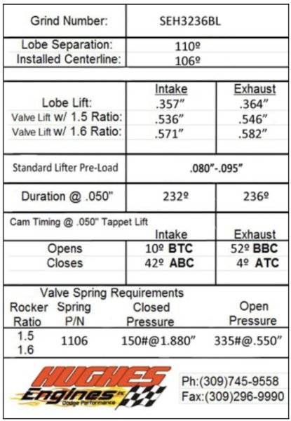

What cam is that?
Which cam are you thinking of installing?
Rich told me his cam specs, I don't recall specifics but it was something in the 230 degrees @ .050 range.
Mine is 261/271 Int/Exh @ .050. I didn't pick it, another guy suggested it back in 2014 when I was dealing with detonation. I bought into the trend of running a bigger cam to bleed off cylinder pressure.
